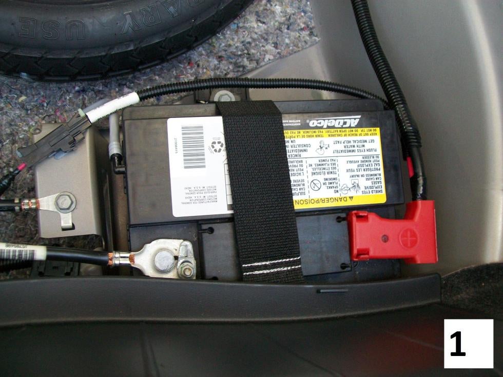

1.) Disconnect both battery terminals. (Found battery in trunk with spare tire) 10mm socket needed.

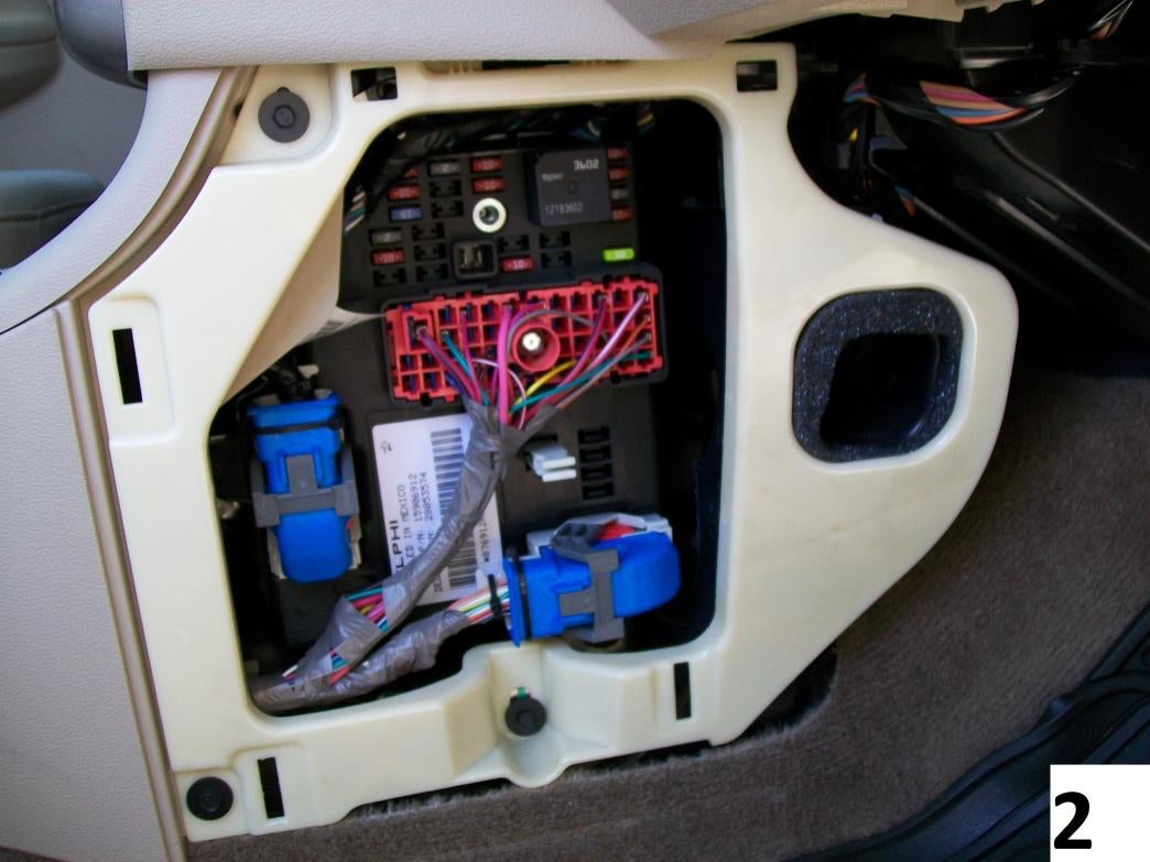

2.) Remove fuse box kick panel held in with 3 snaps, so just pull straight towards you at bottom.
3.) Remove cup holder by prying from the front.
4.) I removed frame around fuse box (3 screws) for better access but you don't need to (7mm heads on screws).
5.) Installed ground wire tab under 10mm nut on lower left of fuse box.
6.) Push 2 little blue tab to remove BCM plug cover so you can insert gray wire female pin in position 61 next to white/black wire(62).Picture slightly out of focus sorry.
7.) Clamp ''T'' connectors onto the 2 pink wires coming out of slot 7 of big red main connector and insert light blue and red wires.
8.) Tie wrap wires.
