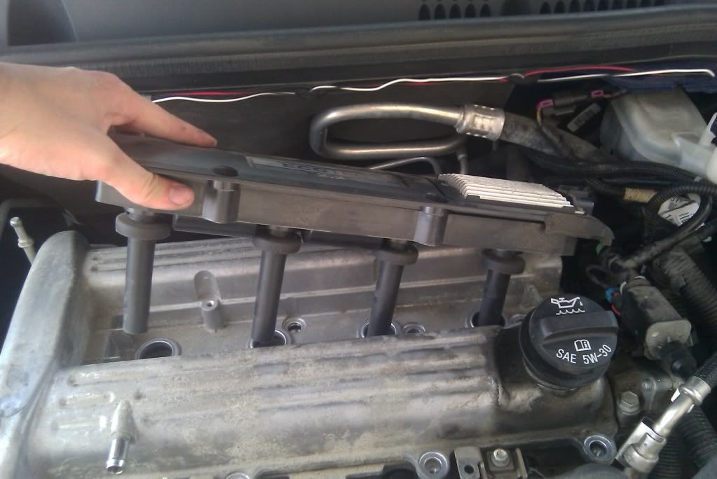

That is your coil pack, my 06 LS has the same thing
---------- Post added at 11:05 PM ---------- Previous post was at 11:03 PM ----------
The piece in my hand

For painting that, bag/tape off the bottom where the spark plug sleeves are, then take off the silver part on the right, where the plug is, and i think you want to tape under that also, then you should be good

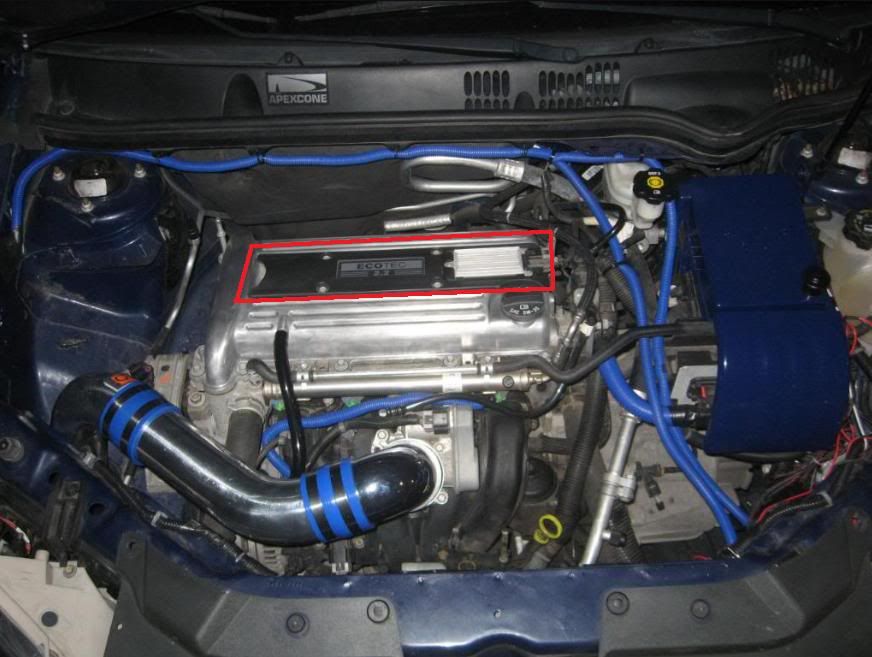

I boxed in the piece the OP is talking about, also a better pic of the engine bay
---------- Post added at 11:26 PM ---------- Previous post was at 11:23 PM ----------
ive never taken off that part on the right, but i know you can, its in my haynes manual, so im sure theres something under there that needs taped, just go over everything once you get it apart and make sure the bottom is covered and any plugs and screw holes
