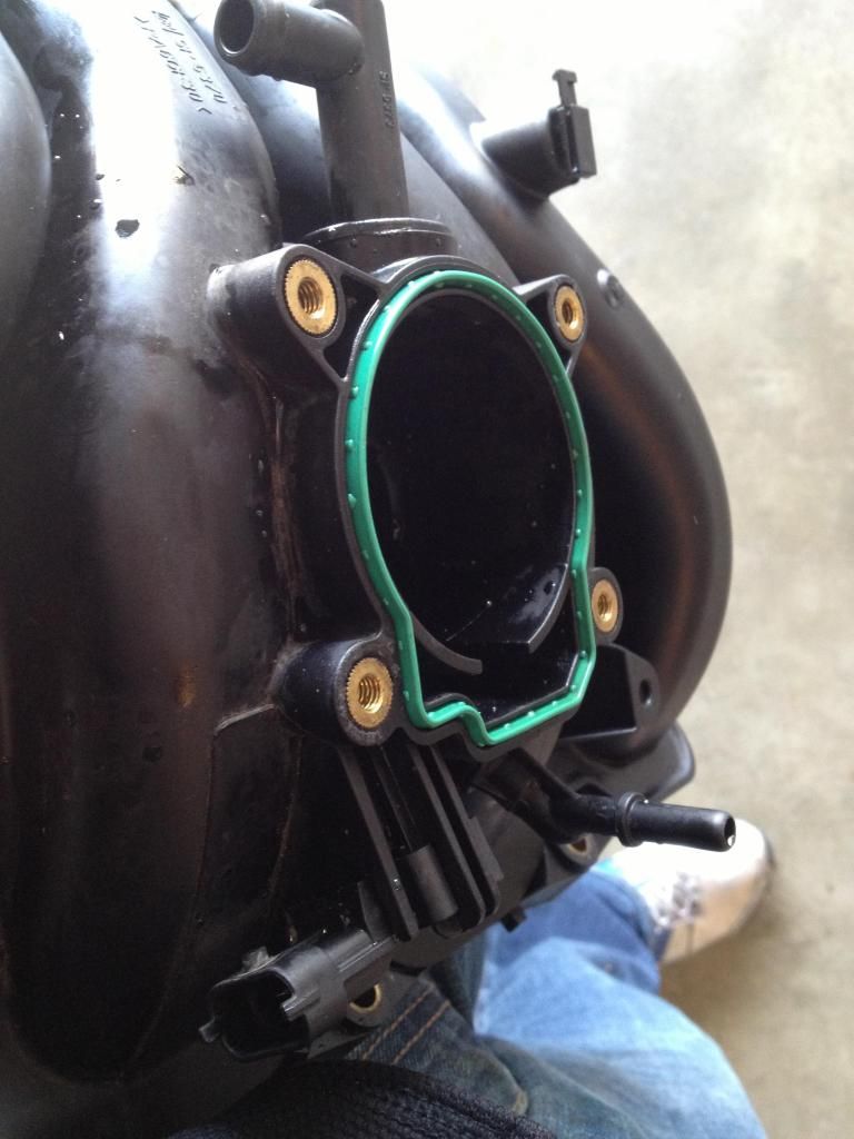

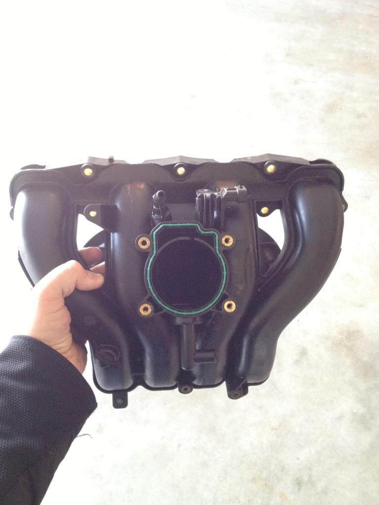

I just bought the intake manifold off of a 2006 2.4 and I'm going to put it on my 2008 2.2. Ive done a ton of searching and have it pretty much figured out but still have a few questions. First off can someone clarify which engines will need an adapter to run the 2.2 TB with 2.4 IM? I read that an 08 doesnt but is that still true for me since I have the older style IM? Also Ive seen posts saying you need the lip that comes off the throttle body but then others say you only need it if you need the adapter. Heres some pictures of the IM I bought. Any insight would be appreciated.

All will need the adapter for the 2.2L TB if you dont have a LAP motor. That is all you will need and www.crateenginedepot.com sells what you need!

Link wont take me to a specific thread. There were only two motors made for the 2.2L engine. The L61 and the LAP. If you have the LAP then you already have the 2.4L IM and you just wasted your money. If you have the L61 you need the adapter.
