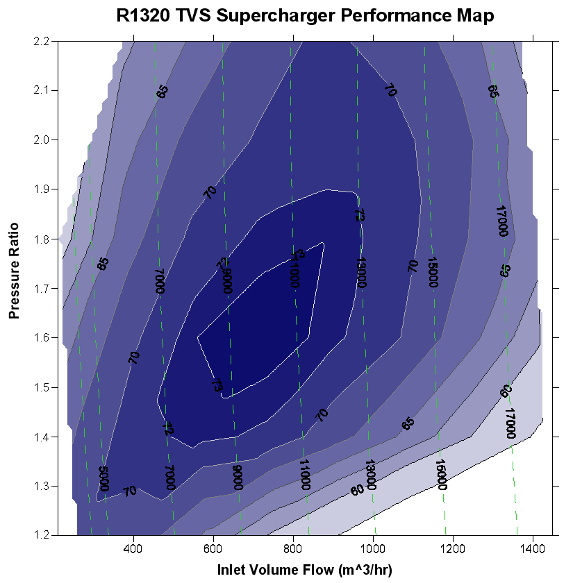

Originally Posted by bluegtp91 View Post
If you compare the efficiency maps from a TVS to an Eaton........lol.
Pulled from a Lotus site, since these guys use the M62 quite a bit.
Compare said pressure maps. Especially since you guys are turning nearly the same RPM's.
In a nutshell, for those that don't want to grasp it.
You're upgrading to a blower that is making the same power, if not more...by spinning LESS RPM's, creating less heat and parasitic loss on the driven accessory (ala, your engine), and has a much broader area to be efficient/make power IN.
If you're making the same power as a 3.0" M62 on a 3.5" TVS, think of what the 3.0" TVS will do...and you're taking 30+ percent less power of your motor, to make the same power, if not more.
This is quite interesting. It's fine for a Lotus, but will it translate the same way for our cars considering we don't rev quite as high?

I wouldn't even think that 1k~ RPM makes that much difference.
You want the darker area anyways, so it's sweet spot is MUCH larger.
Far right and tip top of the graph would be the higher RPM area's.
As you can clearly see, the Eaton just can't even keep pace hardly at any range of RPM's.
For reference, compare said points on both graphs...
Inlet flow of: 800
Pressure of: 2.0
See how the TVS is still pretty well in the beef of it's ability to make power?
Then look at the Eaton graph, see how it's basically teetered off?
Yeah. I wouldn't consider these supercharger's anymore related than that they are belt driven, they whine, use a pulley, and can bolt to an Ecotec.

Also Plain, I forgot to add, Lotus' just use the Celica's 1.8 DOHC VVT 1ZZ series engines...just like the ecotec, a variable valve timing, dual cam'd four banger.
So, I'm pretty sure the comparison would be quite equivalent. I don't think the Celica revs near as high as the Lotus does either..even though it's the same engine.
