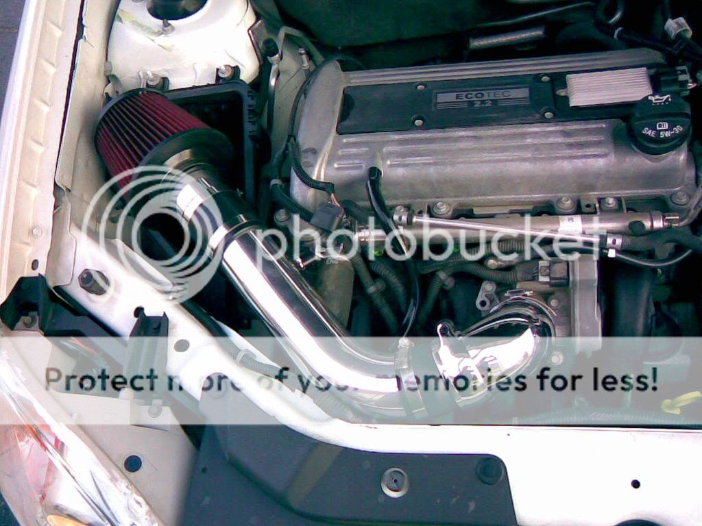

installed custom intake...... when i attach maf sensor....engine dies.....................when its disconnectected...runs ok, cel light shows "maf sensor low volts" but GREAT get up and go from engine.................
by the way....non SAI 2.2L

it may be in upside down?

no, it only fits one way

the maf sensor itself can go either way.
this is the reason we but name brand and not custom

just so ya know, i cut a notch into the 3" metal intake to install the MAF sensor
ok, so it was upside down!!!!! my bad!!!.....i fixed this and my car ran fine for two days........now while drivin on the freeway, 102 degrees out, i get a CEL #PO172 "system too rich"
anyone else experienced this, with a custom intake?

Ya thats very common even in some brand name intakes. NOthing you can really do about it but tune. NO worries tho youre not hurting anything, the ecu just isnt used to that much air intake. I know some peoples ecu have just reset themselves. Just go to autozone and delete the code for free.

i have an actron code reader.....so i deleted the code yesterday.....now its back on.........car still runs fine though... but thanx for the info
