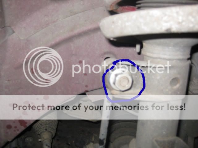

3. There is a bolt connecting the lower control arm with i think an 18mm (might be 19mm), shown here:
Easiest way to remove it is to jack the assembly up like this to remove tension. If done right it will unscrew and come off easily:

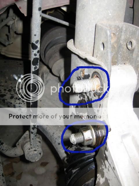

4. Lower the jack back down to let the assembly dangle freely. Now remove the two bolts shown here, i think its an 18mm, and use a small hammer to knock them out.
5. Pull the ABS sensor away from the two bolts. Pull the strut assembly away from the control knuckle, and then whole thing should be only connected by the torx bolt in the strut tower.
