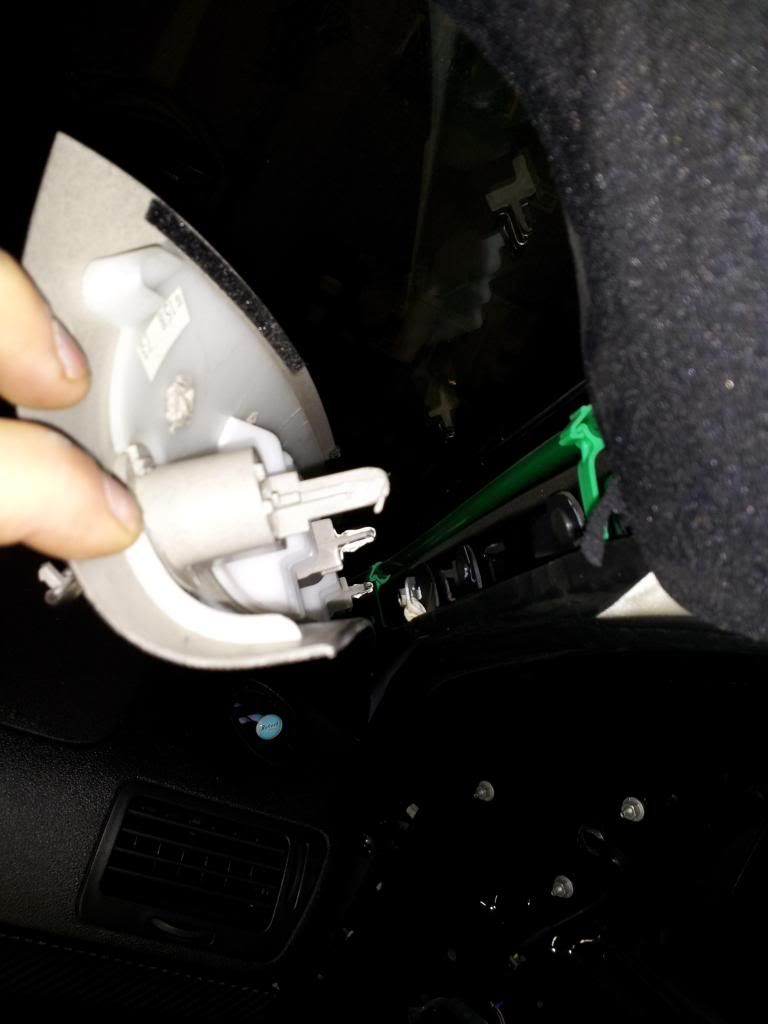

Step 3: Remove A pillar trim-
You will need to pop open the cap that reads "air bag" and unscrew the Torx head screw inside. Next, pull from the top of the trim piece until the first clip pops out of the pillar. Grab farther down and pull out until the second clip pops out and slide it out from behind the dash.

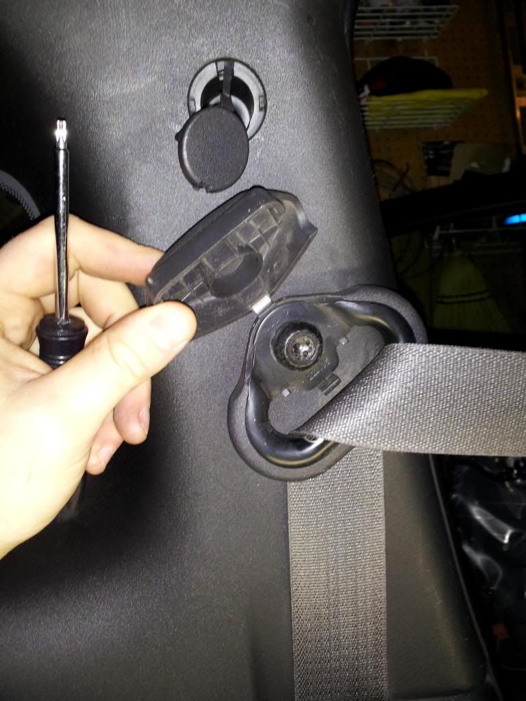

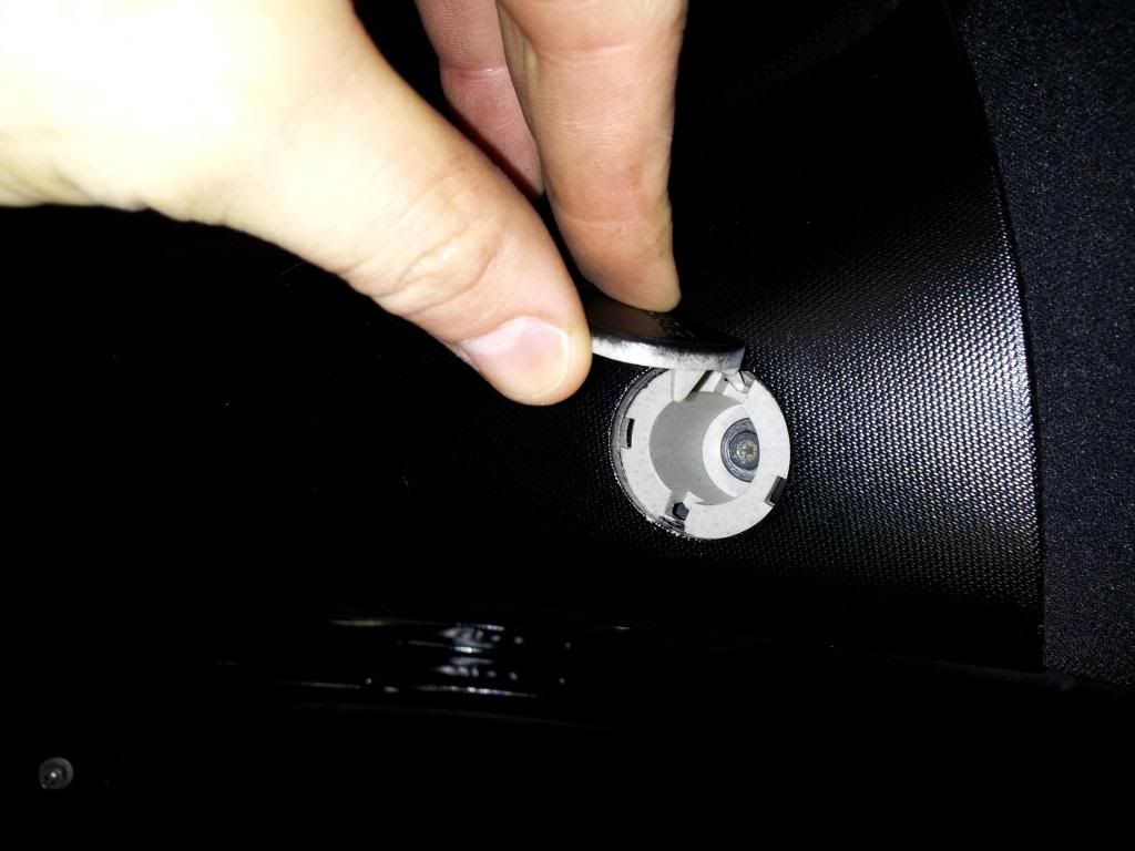

Step 4: Remove B pillar trim-
Again, pop the cap with your flat head and remove the Torx screw. Next, you will pop the cover off of the seat belt and remove that Torx bolt (this one is really in there and will require some serious force. Make sure you are using the correct bit so you don't strip the bolt). Pull trim back, there should be two more clips to pop out.
Pop cap and seat belt screws exposed

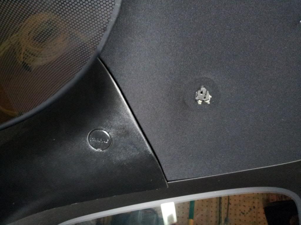

Step 6: Remove C pillar trim-
Although there is a cap here there are no screws behind it (at least in my 05, you might want to double check just in case). Similar to the A pillar start by grabbing the top and pulling out until you hear the first clip pop out. There is one more towards the bottom and you are all done.
C pillar location

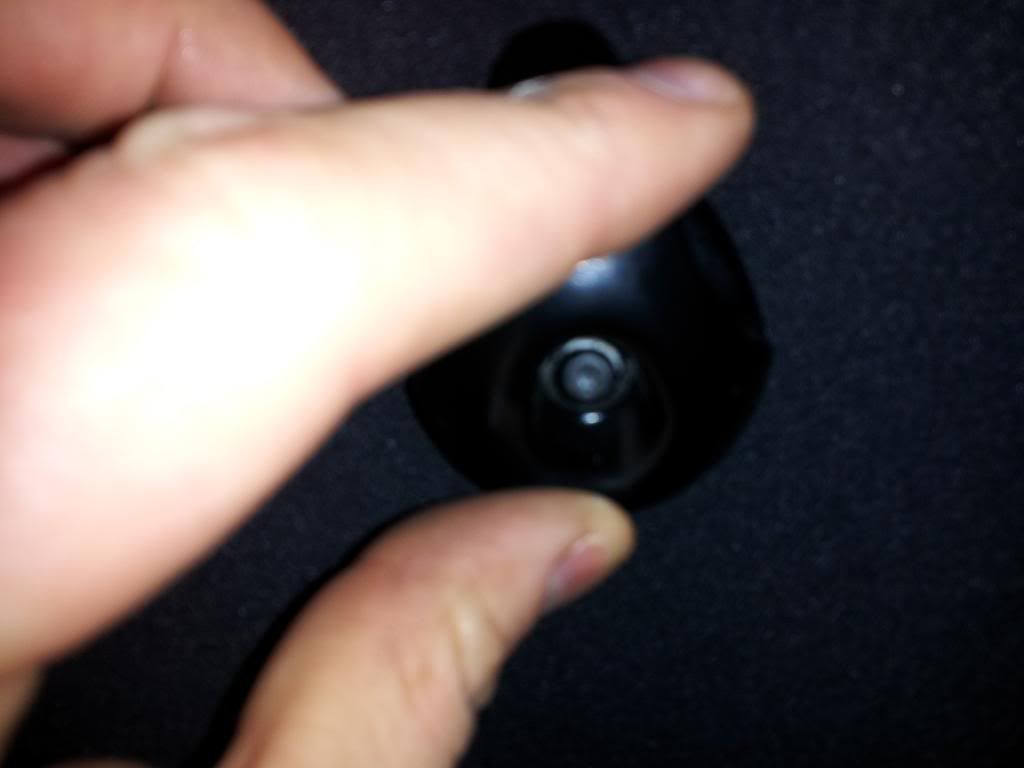

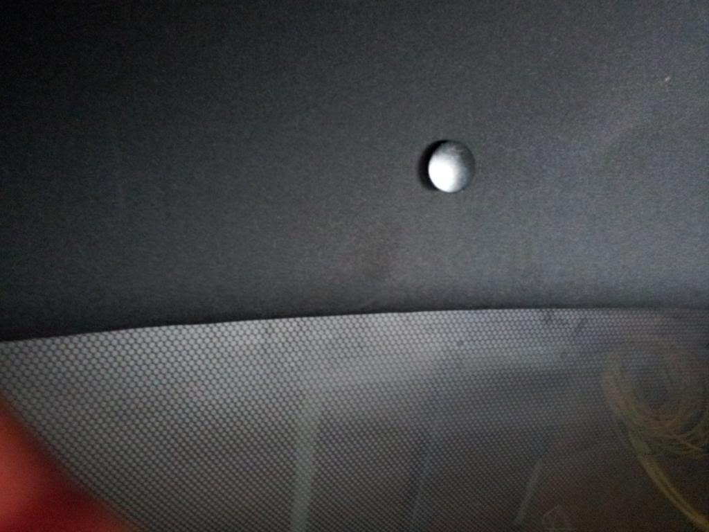

Step 7: There is a friction screw near the back window designed to support the middle of the back half. Take two flat head screw drivers and wedge them between the head of the screw and the liner then gently force it out.
View of friction screw

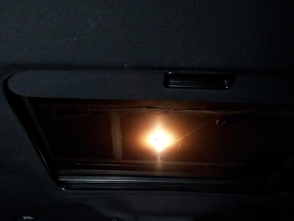

Step 8: Remove trim shroud around sunroof opening by finding the seam where the two ends come together and pulling it out.
View of shroud

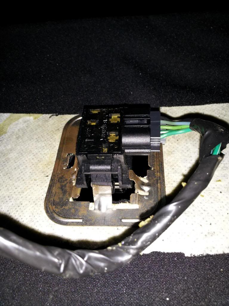

Step 10: Unclip the window control harness from the switch near the front.
View of the sunroof toggle from behind headliner

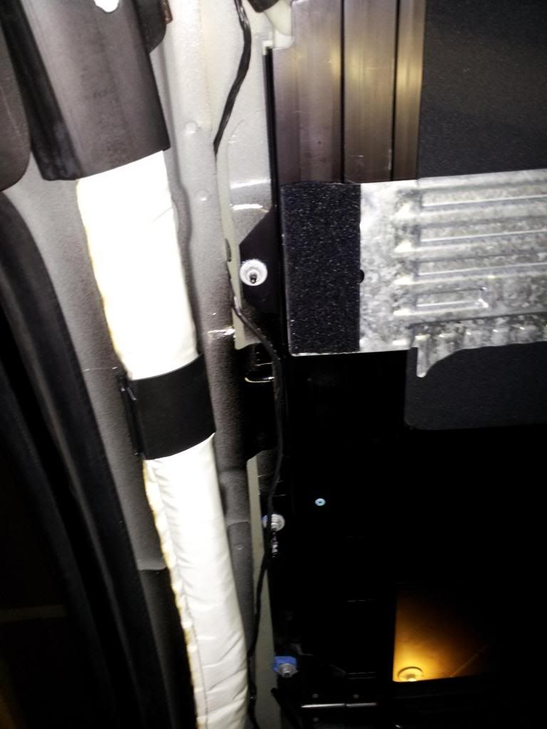

Optional- If you plan on changing your headliner material you will want to change the sun roof screens material as well. Here are the additional steps to remove the sun roof.
Step 12: Unscrew the nuts holding up the sunroof with your trusty 10mm (you may want an extra hand to hold it up).
View of nuts holding sunroof in place.
Step 12: Disconnect the four run-off tubes at the four corners of the roof and lower.
