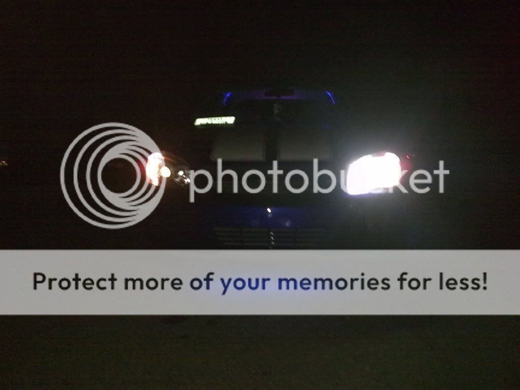

so both halo rings on one of my headlights is blown out, i was wondering if its possible to put one of the working halos on to the faulty head light that way it can give it an evened out look
heres wat im talkin about:
i take off 1 working halo from the other headlight and put it here..

You got gen two right. Well mine right side is burnt too. I ordered a ballast on eBay for 10 bucks. It's ussually the ballast and not the bulb.

my did the same thing... so i just cut the wire to the halo's and led's and left them as lights.

I would just unplug the top white plug. It disables the halos

oh ok, not to sound like a dumbass but wats a ballast

It's what the halos connect to on the inside of the headlight and that's connected to the power plug

The ballast is what usually burns out. I opened my lights up and cheked the if the halo
was burnt. It wasn't cuz I unplugged it from the ballast and plugged it to the eyebrow ballast and it worked but it's not as strong to power it

ooo ok and wat do i type in when i look for it on ebay

Type in ccfl power inverter
