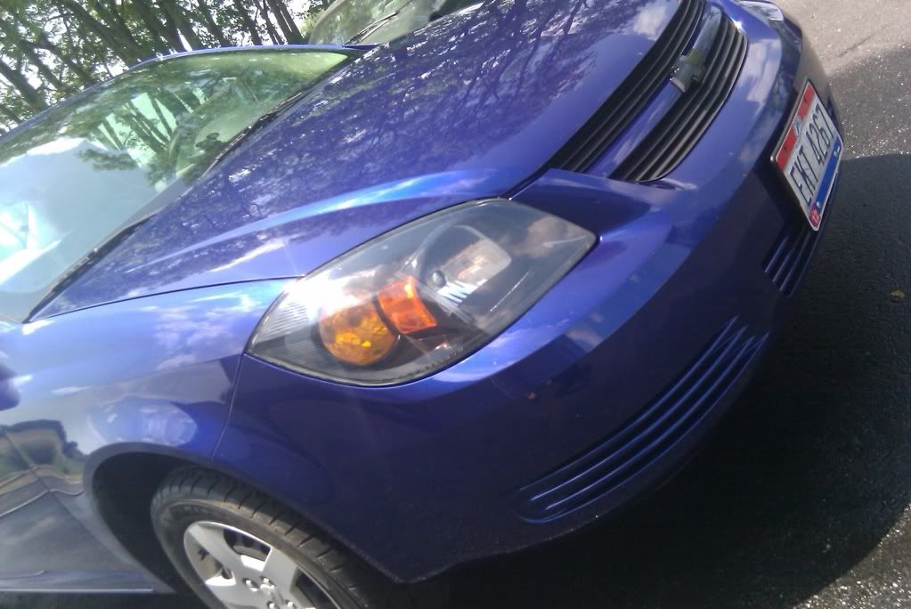

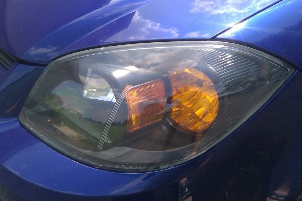

My lights are all blacked out now, VHT nightshade in the rear, sprayed, clear coated, then wet sanded and polished with scratch fixer and turtle wax. Also instead of the tint on the front lights you can take your headlight housing apart and paint the chrome piece black, then it will be black but the lens will still be clear and wont affect your light output

turned out sweet man
