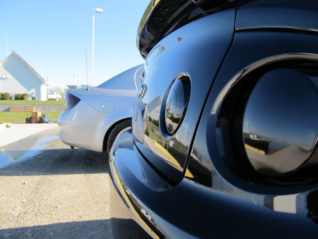

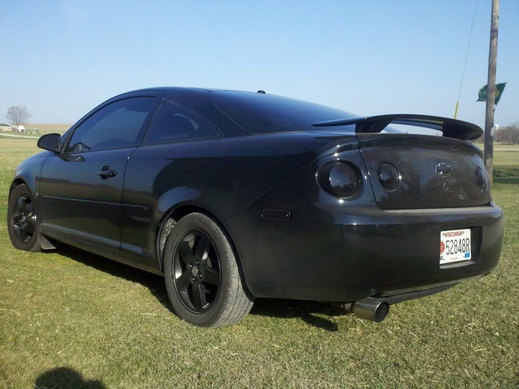

i used VHT nightshades on my old car and they came out perfect. It does take some patience though to do it right.
you going to want to scuff them with like a 2000 grit sandpaper then wipe clean
spray 2-4 even light coats of VHT (depending on the darkness you want)
spray 3+ coats of clear after the VHT
then your going to want to wetsand with 2000 grit once again then polish them to a shine with meguiars scratch x2.0
heres the results on my old LT, ignore the dirty car.. they came out super glossy. I did 4 coats of VHT.. total cost was maybe $15 at most
when clean :D
when clean :D
Yeah it looks really good! But I've already nightshaded my tail light (I did it last year) so do I do like 2-3 coasts or I scuff them and start it again?
