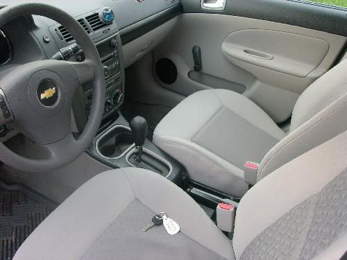

here's my interior...
the paint that i used on the dash trim was just a random can of spray paint i found kicking around in the garage. i used a bit of clear coat on that for extra protection. for the doors and center console i used the krylon fusion satin black. it's supposed to be pretty tough stuff so i didn't bother clear coating. it's been a few months now and i haven't had a problem with it yet
