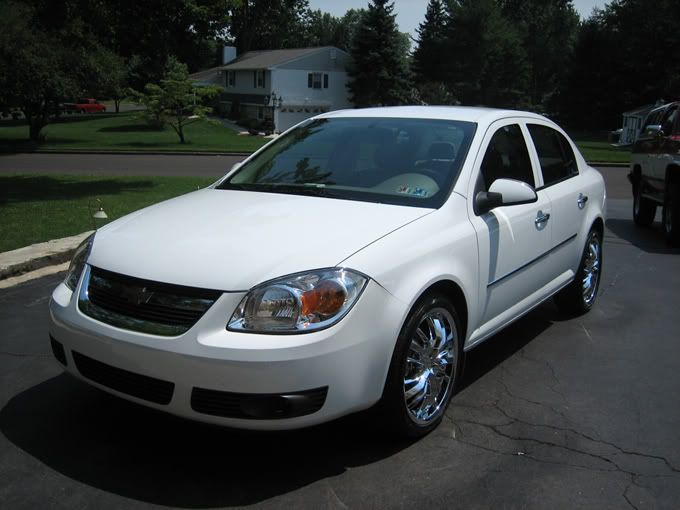

heres what i spent my week-end doing
With out lights
With lights
only cost me about 40 bucks and a tone of time cant really notice that i meshed the fog light area.

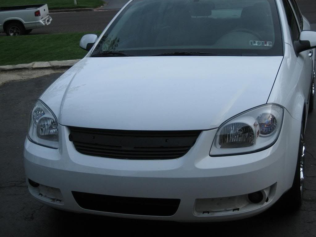

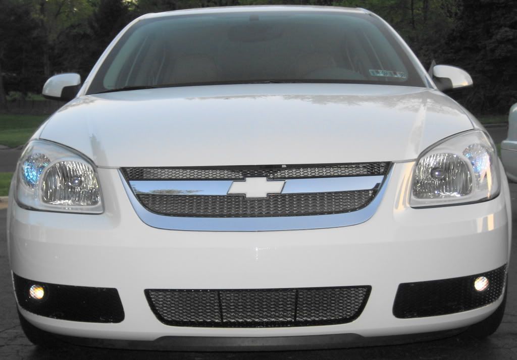

i removed the amber lens for the turn signals and painted the inside of my headlights to match my body color. Also it was stucco mesh from lowes for like 7 bucks i had more then enought
to do all three grills. Sucks having the LTZ and having to mesh around the chrome as you can see in the WIP pic.The fogs i didnt cut, i wanted too but i just taped off that area and painted black and then cleared it and same with the bottom middle grill. for the bottom grills i just cut tabs to line up with the tabs on the bumper from the old plastic grills folded in and j.d. weld (epoxy) them on the inside
If i have too froms stone chips i can pop the fogs out and tape my bumper off and paint it over agian on the car.
