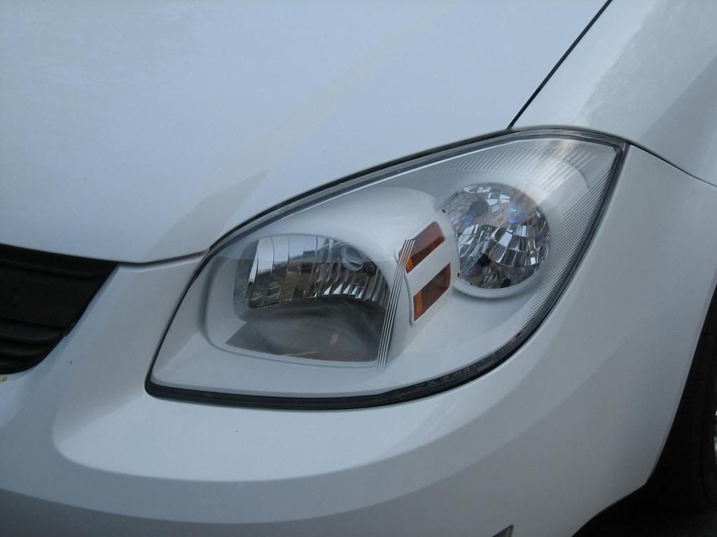

i have a pair of stocks painted on my car but these projectors are for my girls balt, i tookt he projectors apart tonight. The glue was easier to get off but still no easy feat. I'm thinking of different ideas on how to paint them should i paint the top white to matcht he body color and leave the bottom half black.. or should i go all white?my stocks are all white and they look nice.

i like how you painted the yellow reflector. May have to steal that if I ever get to painting mine
