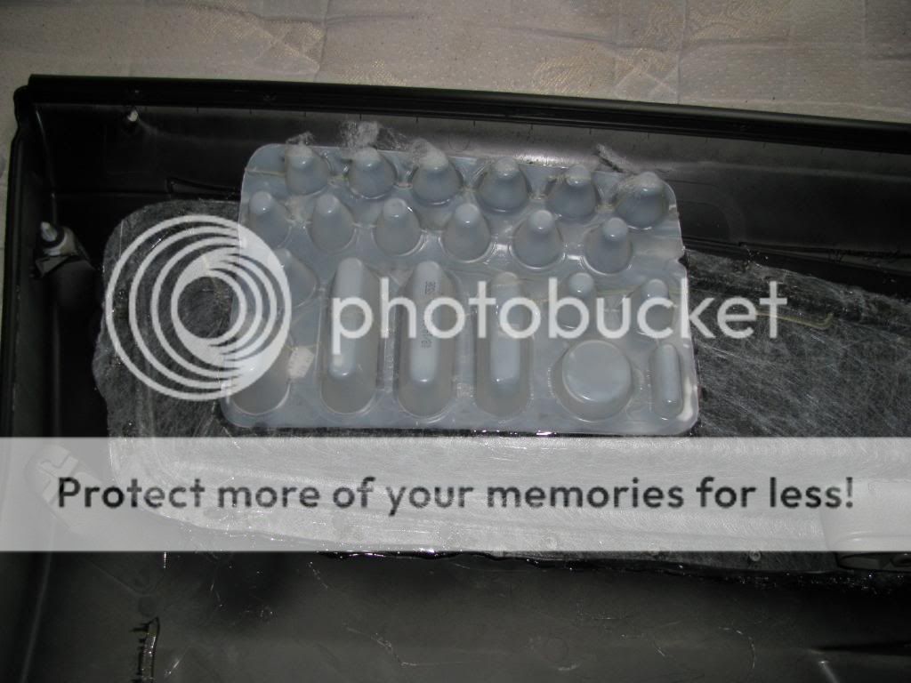

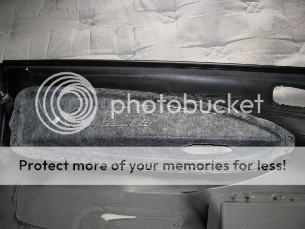

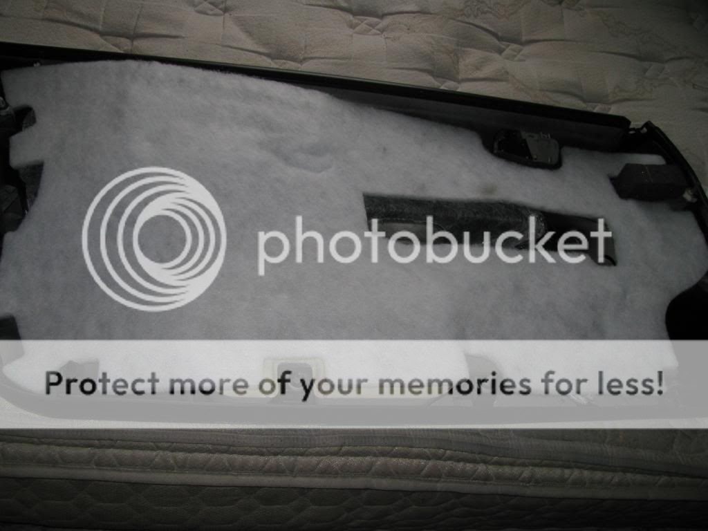

Once you have your door panel removed from the car, it is time to get it prepped. Start by flipping it over so you can see the backside of the panel. Remove the white insulation, and the plastic thing over top of the insert (Refer to 3rd pic). Just pull on it, it will come right off. Next remove the door handle cup (If you have power windows/doors it's the same way to remove it) Just push it upwards and it will pop right out.

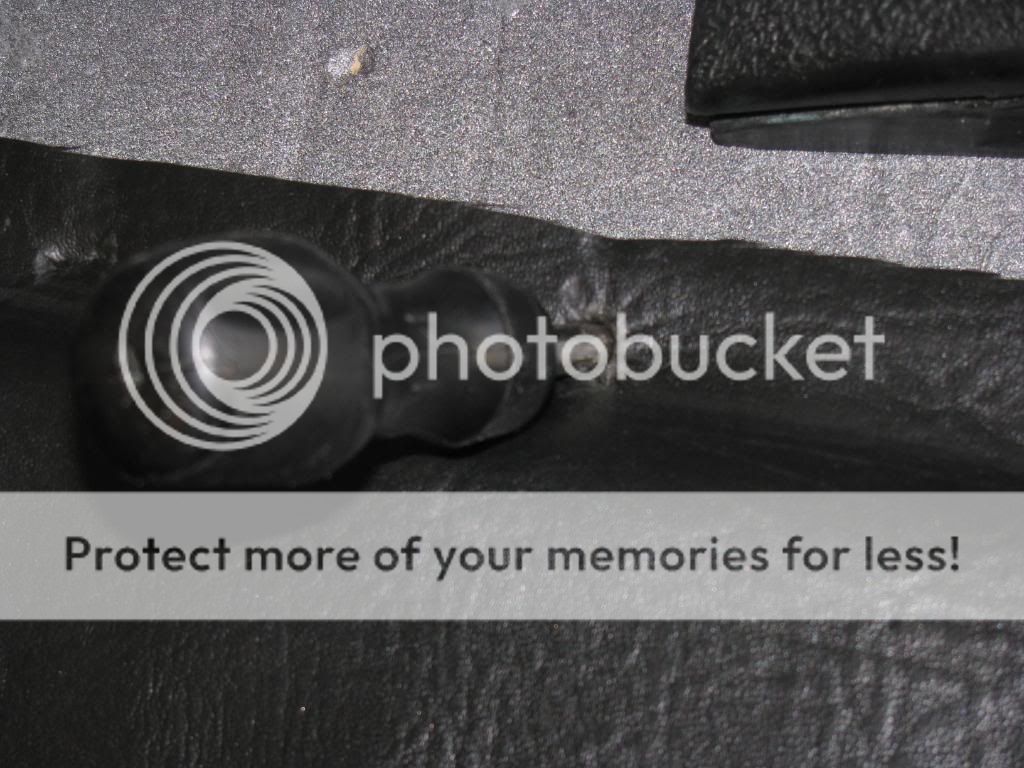

Once the soldering iron is well heated, safely start to melt/pry the plastic weld tabs that are holding the insert in place (Refer to pic) Now just continue the entire way around the insert until you can simply pry the insert away from the door panel.
This is what a removed tab looks like \/

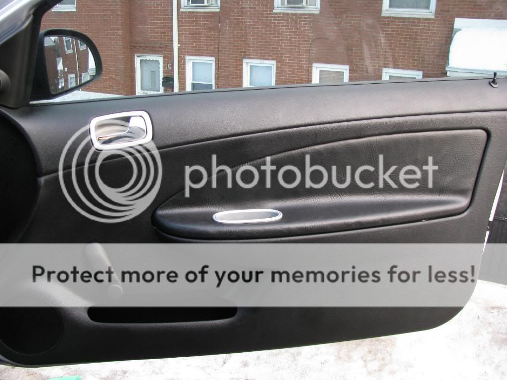

And this is what the finished product looks like all installed.
