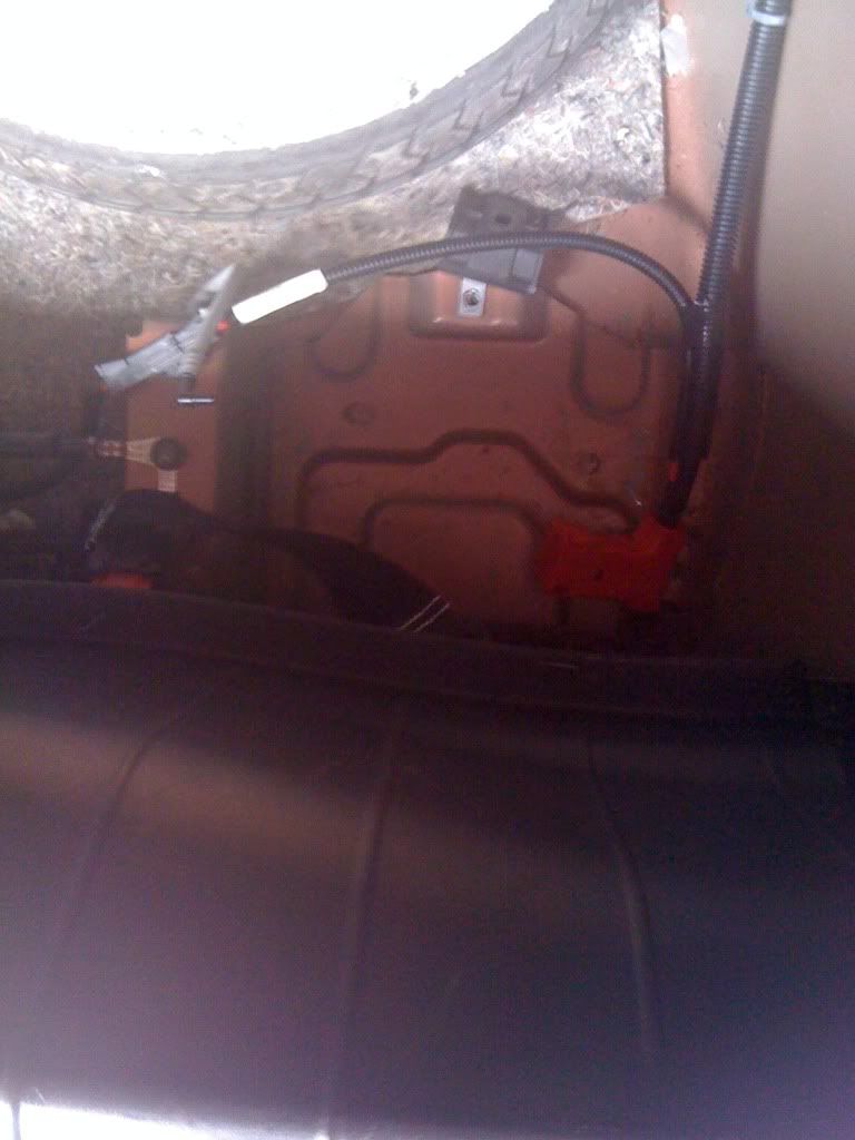

Step 1 Open truck, remove anything in there, and remove the carpet panel, exposing the spare tire well and battery box.

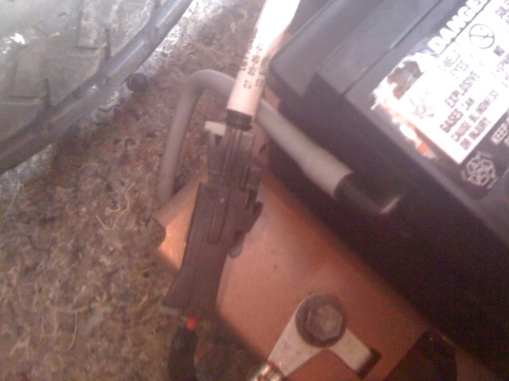

Step 2 On the left side of the battery is a small gray wire on a small plug. Find this and wiggle it gently and pull it out of the battery, tucking it out of the way

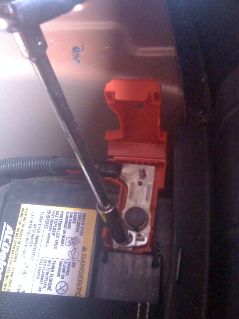

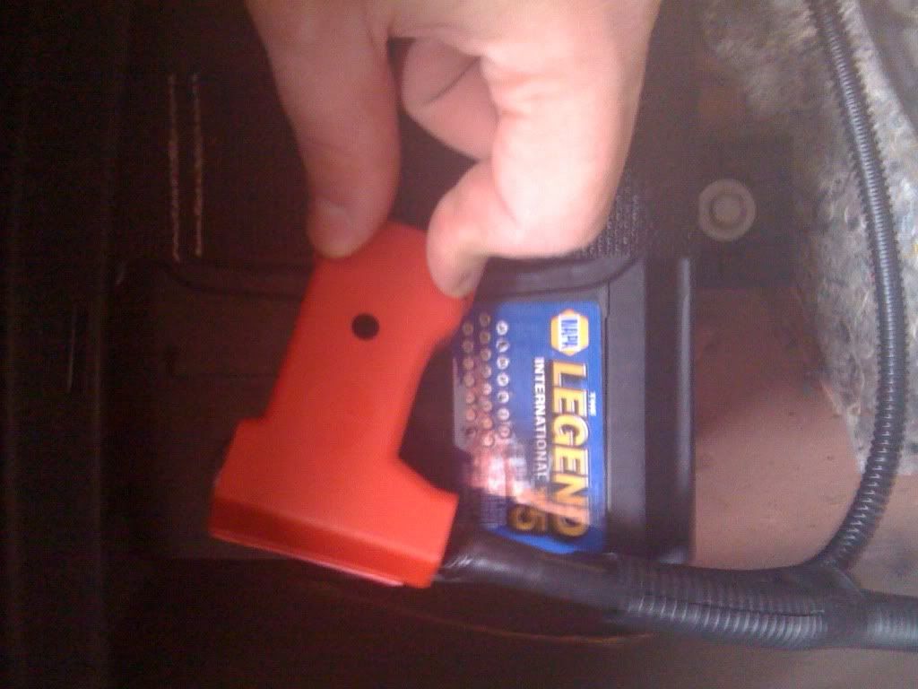

Step 3 On the positive terminal of the battery, release the terminal cover. Push in the two tabs as shown and lift.
This will expose the Positive Terminal.

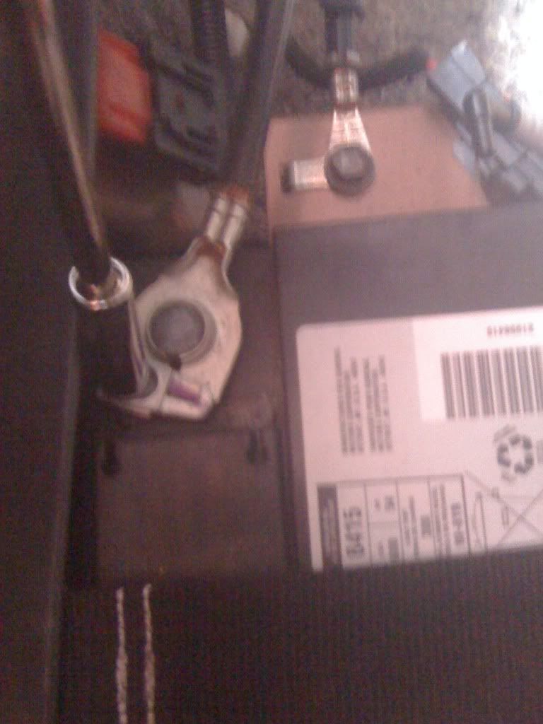

Step 4 Using a 10mm socket on an extension, carefully unscrew the positive terminal. Once it is loose, wiggle it up and off, snapping the cover back over it, and tucking the wiring harness out of the way of the battery.

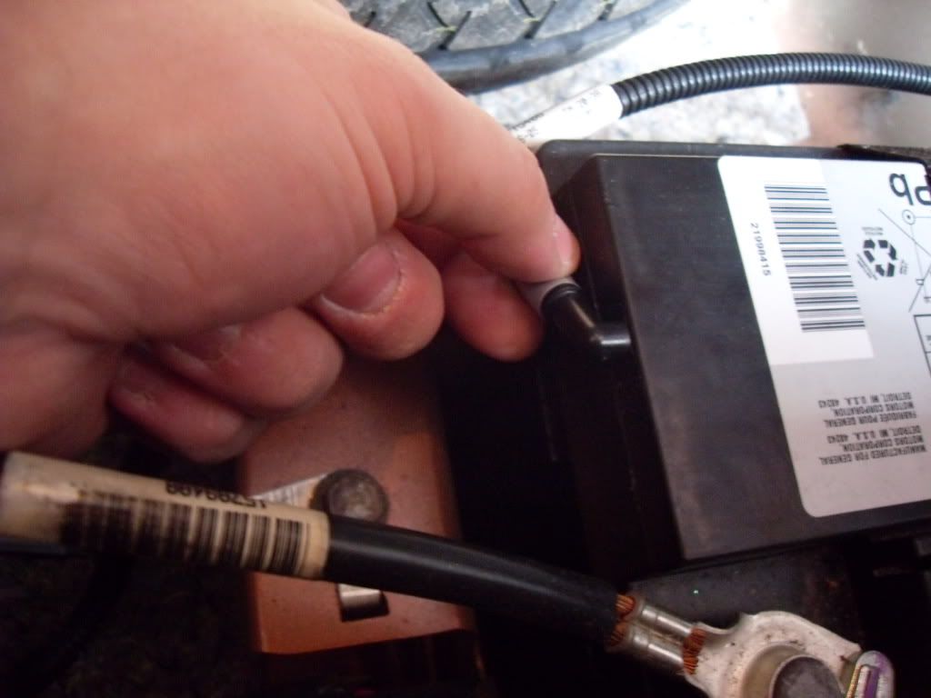

Step 5 Goto the negative terminal, again with the 10 mm, and carefully unscrew and remove it.

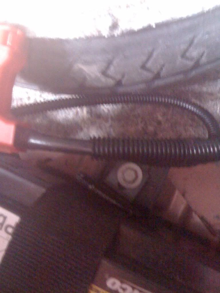

Step 6 Make sure the terminal cables are tucked out of the way so you can get the battery out. Switch your tools for a 13mm, you need this to release the battery holding strap. This bolt is located towards the spare tire, and is just one bolt.
Unscrew the bolt, lifting the strap out of the way. The bottom retainer isn't mounted in, so make sure you don't loose it r the thread zerk. Lift the cable out of the way.
Step 7 Remove battery from trunk, compare to make sure new battery is of the right size and spec
Step 8 Carefully set the battery in the trunk, terminals to the rear bumper, negative to the drivers side, positive on the passengers side. Run the strap over the top of the battery, and put the 13mm bolt back in, tightening it snugly. This is all that keeps the battery in place, so make sure you don't skip this step.

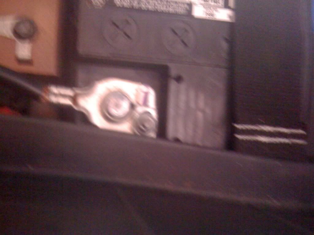

Step 9 Hook the positive terminal back up. Lift the cover, slide it over the post on the battery and tighten down the bolt snugly with your 10mm. Then clip the protective cover over.
Step 10 Hook the negative terminal back up. Slide it over the post on the battery and tighten down the bolt snugly with your 10mm.
Step 11 Locate the small gray wire and reinsert it to the hole on the drivers side of the battery.
You should be good. Go turn the car on, make sure it all works. Then put your trunk carpeting back in.
