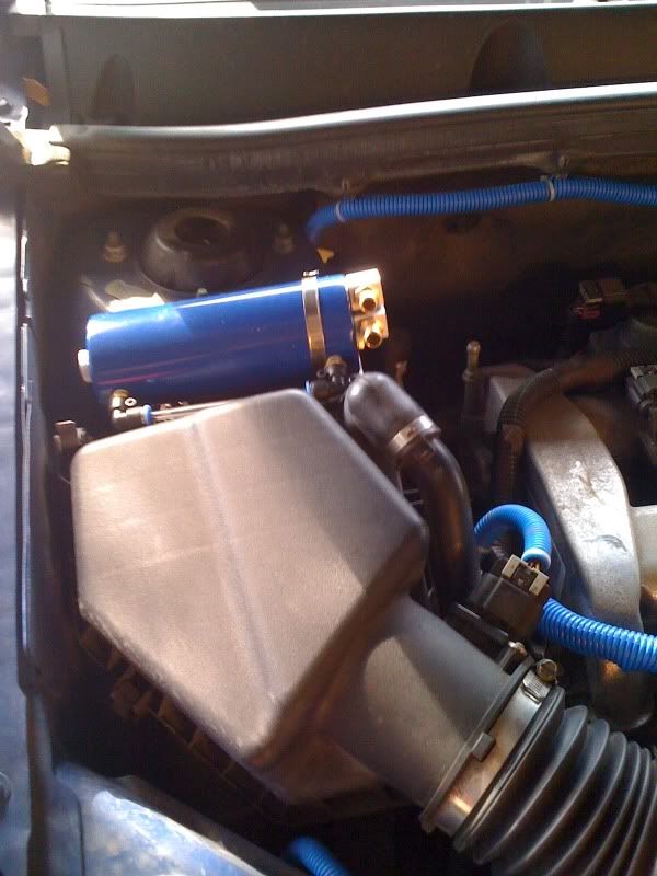

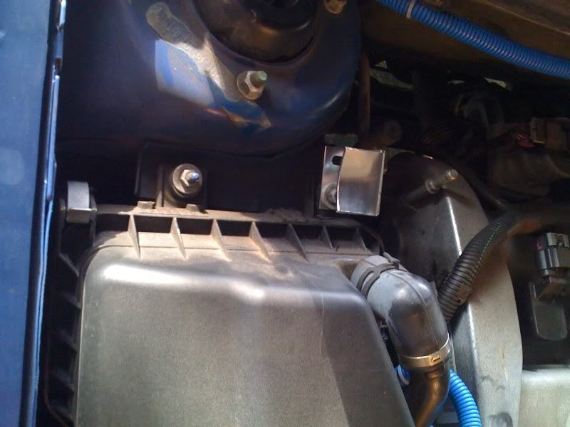

Here is where i put the mount
Mounting the catch can.. its on a slight angle hopefully that helps, before going any further make sure your hood closes with the can in place

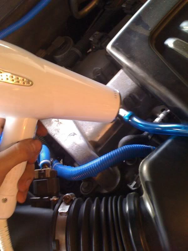

Use a hair dryer to get the hoses on.. it makes this A LOT easier.. just heat the hose up for a minute or 2 then while ur sliding it on heat it up a lil

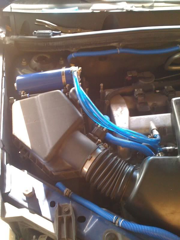

Run the hoses over to the can

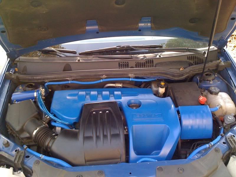

Add ur engine cover (if u still use it, i do cause i dont have time to paint the valve cover)
FINSHED PRODUCT
