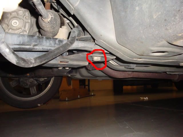

jack up the car and remove the control arm by removing the 2 front control arm bolts(15mm head)
rear control arm bolt(21mm head)
the ball joint bolt(16mm nut,15mm head)

slide rear portion of control arm into frame and loosely install the bolt.
install ball joint into the steering knuckle and loosely install bolt/nut.
install the 2 fore/aft limiting brackets onto the front bushing followed by the 2 bolts.
torque the 2 front control arm bushing bolts to 41lb ft.
torque rear control arm bolt to 74lb ft plus 180 degrees.
torque ball joint bolt to 37lb ft, then loosen 3/4 turn,re torque 37lb ft plus 30 degrees.
