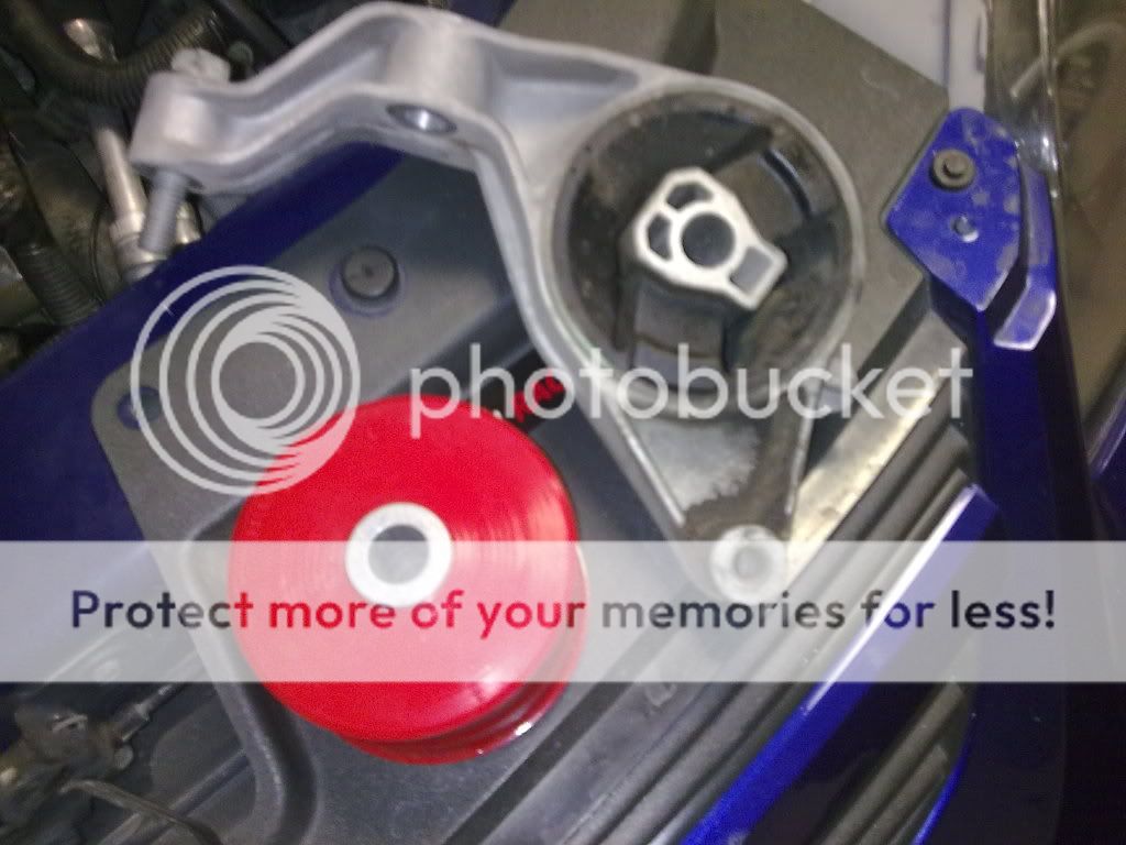

Ok people this is my 1st time doing a how to so bare with me:
Tools you need
*18mm socket wrench
*one C-clamp
*all though if you have a press i HIGHLY recommend you use it..lol
*2 jacks
this is for the front tranny mount:
1st jack up the car, then with the other jack, jack up the tranny just a tiny bit..
now theres gonna be 4 bolts your gonna be removing, the first one is as shown..
then remove the second bolt which is on the opposite side of the mount
after you get that done, look above the bushing and theres gonna be 2 bolts where my finger is pointed
the mount should slide right off as soon as you get all 4 bolts removed and it should look like this
now here comes the pain in the ass part...if you have access 2 a press then no problem but if you dont heres where the C clamp come in, put the mount on a surface where the bushing will be over the air, then put the clamp on the center of the bushing now start tightening the clamp until the bushing pops out...
when the bushing pops out then reverse the steps to put the new bushing in, same with the mounting of the tranny mount and it should look like this..
this is the first part of the how to, i dont have the second mount on yet but when i do ill finish off the how to...like i said before this is my first how to, if i made any mistakes on the instructions then let me know

it takes like 15 min to get the mount out but to slide the bushing out of the mount, took my friends and i bout 1 hour lol

well i havent put the rear mount on yet, its kinda hard 2 reach :/

yea same size and everything....ill see if i can get the rear mount done on sunday cuz im gonna be busy friday and saturday

nice how to! great use of a c-clamp and some weights lol. also torque specs:
Transmission Mount to Transmission Bolts
89 Nm
66 lb ft
Transmission Mount (Rear) to Frame Bolts
60 Nm
44 lb ft
Transmission Mount Through Bolts
100 Nm
74 lb ft
