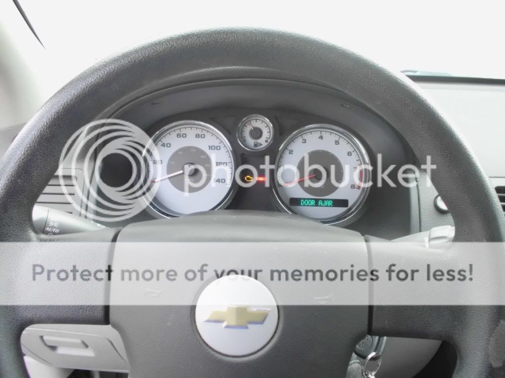

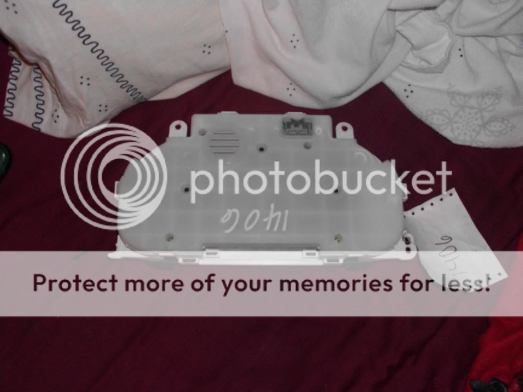

Finished the install a couple hours ago and it went great! Everything works again and the new cluster looks WAAAY better than the old one. I went from the LS 2.2 black cluster to the 2.4 SS white cluster.
Anyway i'm not doing a write up or anything because there is already a great one i used from this forum. And the whole operation took 15 minutes from start to finish. Plus I did it all inside the car with the door closed in the rain, with two tools. Oh yea and it cost me a Whopping $30!
here are some pics
