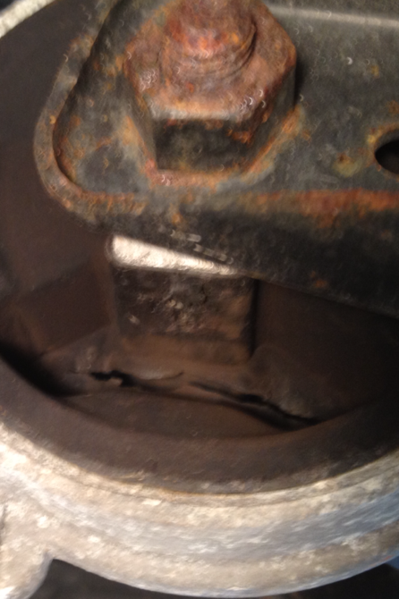

Hey guys idk what I should do about this mount, does it look really bad, how long will it last?

Looks OK to me, it's not seperating from the metal, it's not cracked and the little tear you see is just the surplus rubber from the mold.

that mount will ot give you any trouble. i would recomend just watching it periodically, but i wouldnt do anyhting serious. that mount though is relatively cheap at a junk yard though $30-$50

I have a poly insert you can buy, but that one still looks like it will last a while.

Yup looks good to me what about the other mount on the left side of the engine

What kind of mount is this, I know its not a upper engine mount.

Transmission mount. Not sure if its front or back due to the picture.

What year? The design changed in 07.

There is nothing wrong with that mount based on your pictures.

Its the front I figured out, and my cobalt is an 05, I just kind of want to buy new ones just to prevent anything I know that they cause problems later on
