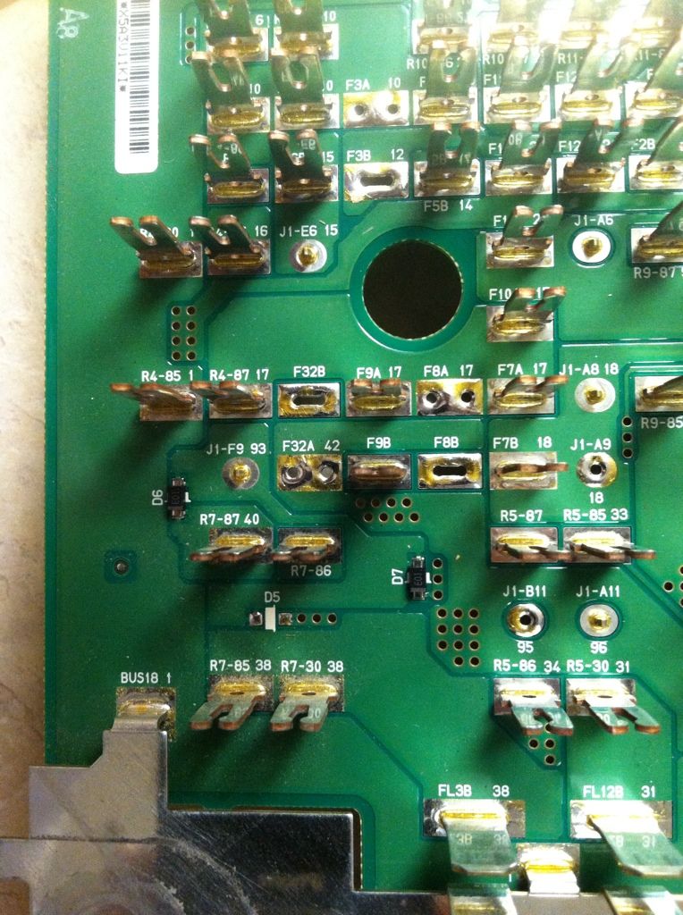

Ok, so...Thursday Jan 31...had a CEL pop on. Went to have it read...car chucked like 32 DTC's leaning from heated o2 codes, to EVAP, to MAF, etc. Cleared them (btw car was idling like crap, MPG's weren't besting 20~ even cruising on the HWY). Called a buddy of mine who works at a local dealership who pointed me in the direction of a fuse titled "ENG VLV SOL"...and I really was "SOL". Pulled the fuse...it was blown. Simple fix, YAY! Swapped the fuse, car ran great...fast forward to Saturday, leaving work around noon (yeah, bankers hours...wheeee), funky idle kicks on again...CEL is back. Awesome. Go to the parts store, same situation. I think, ok, now I've got a wiring problem...it's popping fuses. I check the fuse...it's good...WTH?
As I put the fuse back, I realize that there is nothing holding it in.
That's right.
I get home with that awesome 18~ MPG's...rip apart the factory fuse box to find out that the terminals are no where to be found on the motherboard and pin F8A 17 and F88 were non-existent. Checked everywhere...found nothing. Junkyards had nothing as well (since the '06 Ion fuse box internals are different I got boned and wasted $17~ there as well). Turns out, no one locally sells anything like that...so, the soldering iron was whipped out and went to work. Removed the DRL pin from the top of the motherboard, soldered it in down on the F8A/F88 location...reverse angrily...and; car runs great.

Like I stated...
F8A/17 and F88.

wow, its just gone lol thats nuts

The craziest part about the whole thing was that it's a pretty much sealed...everywhere.
No where for them to go.
Couldn't find them anywhere...pieces in the harness, bottom of the box that was still in the car, inside the case itself...just...gone.
