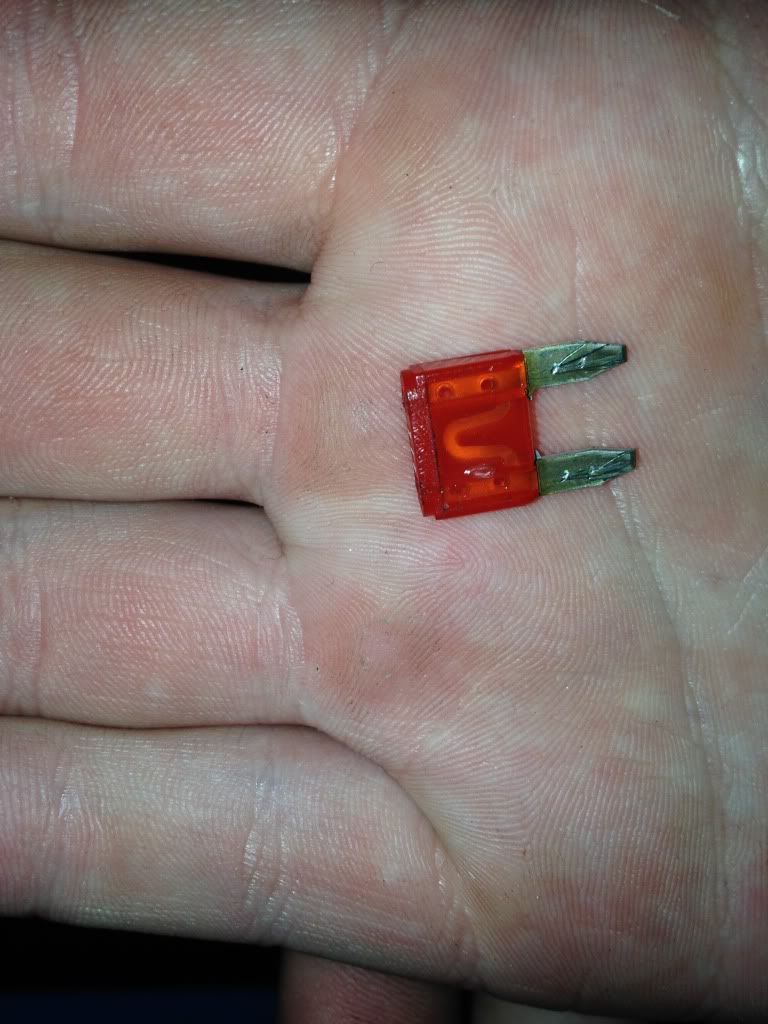

Change the TCM/ECM fuse top left corner of BCM fuse block. Fuse is only $1, if it cures your problem great, if not no big loss. Pull and re-insert all fuses if you have the time.

post #5 of 15 (permalink) Old 11-18-2013, 01:04 PM
If the fuse looks like this change it for sure.
post #6 of 15 (permalink) Old 11-18-2013, 01:06 PM Thread Starter
Join Date: Dec 2012
Posts: 428
Nope doesn't look like that by far

post #7 of 15 (permalink) Old 11-18-2013, 01:14 PM
is it tarnished any?
post #8 of 15 (permalink) Old 11-18-2013, 02:30 PM Thread Starter
Join Date: Dec 2012
Posts: 428
I'll take pic

post #9 of 15 (permalink) Old 11-18-2013, 03:13 PM
I would change it and see.
