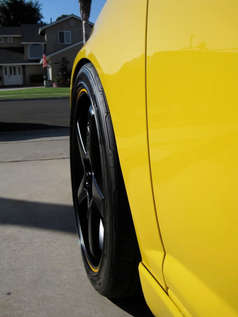

8.5 in 38 should be fine. an 8" wheel should be able to clear in any offset between 45 and 35 hope this helps.

35 moves the wheel further out, so an 8.5 would be fine.
keep in mind this is a 19" wheel however...
