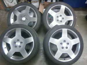

Today I will go to take a look at SS/SC rims and probably will buy it cuz I saw pics of them and they looked prety good. I will buy them with tires so my questions is , Do I have to do aligment and if yes, I will probably buy Springs in two weeks, Can I drive with no aligment for 3 weeks or so ????
I dont want to do aligment for the rims and the tires and then for the springs again just in the 3 week.

Yeah but I wont get only rims I will get rims + tires on the rims allready
This is what I getting

Allright, this is what im going to do then
