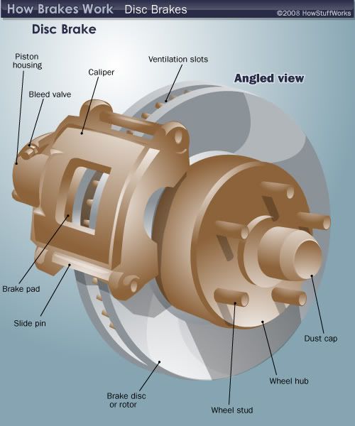

Woops, I guess I should have explained WHY I want to change my rotors, lmao.. sorry, I was in a hurry. My car shakes when I brake ~40+ now, used to be ~60+ (mph), and I was told to change my rotors. I was asking here because I'm not sure where the rotors are located in relation to the brake calipers, but if they're in the same place then I might as well, ya know?
I had this problem a couple of months ago...I would re-surface the rotors first
After I had my rotors re-surfaced braking was back to normal
But yeah definitely try resurfacing before buying brand new rotors...it would save some money and time
