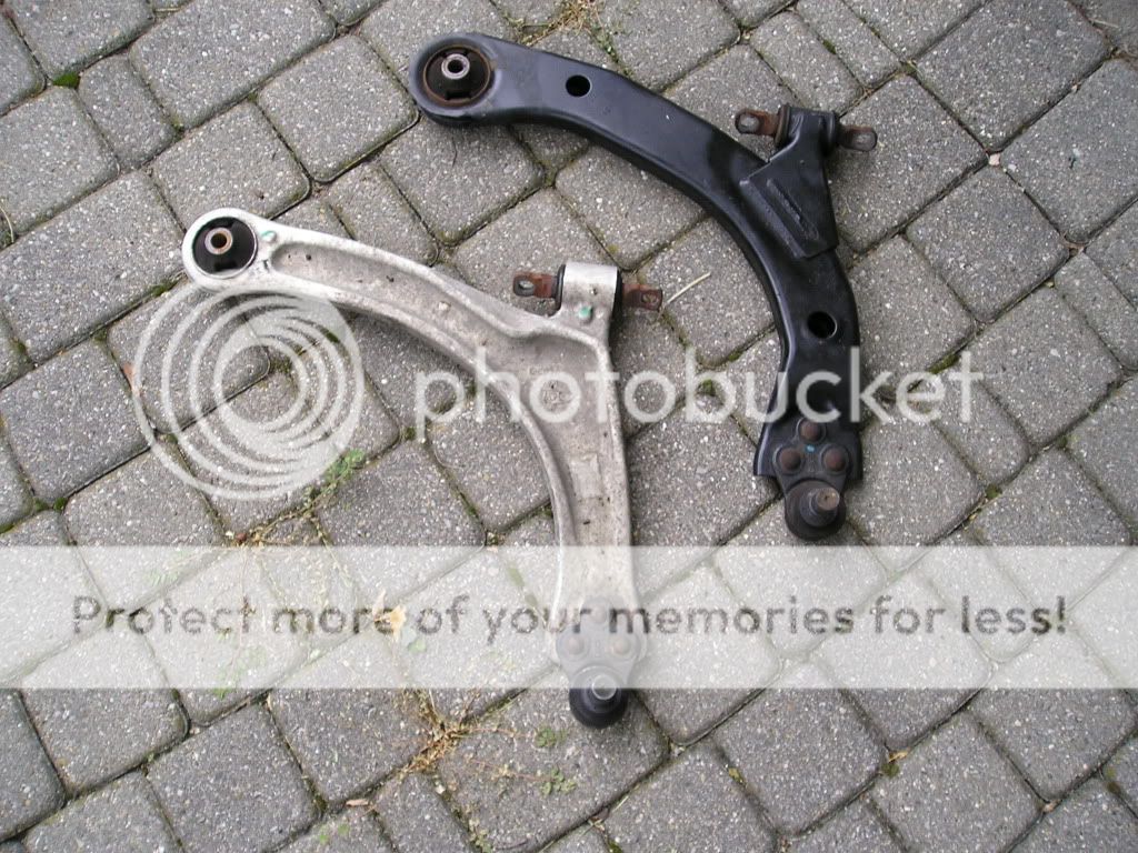

I swung my trans mount up. My control arms were out of the car when I did it. Though I didn't really move the cradle.
Lets see what I got.
---------- Post added at 10:29 PM ---------- Previous post was at 10:22 PM ----------
You can see the vertical rod end bushing on the control arm (on the left "wing" of the control arm) - that slides into the cradle. Big ol' bolt.
---------- Post added at 10:30 PM ---------- Previous post was at 10:29 PM ----------
You'll be able to see the trans mount from above and below. There's a horizontal bolt that connects it to the engine, and 3 3847628746238746 foot long bolts on the bottom that bolt it to the frame.
---------- Post added at 10:39 PM ---------- Previous post was at 10:30 PM ----------
No pics for the trans mount - but it's easy to spot. You pretty much just gotta twist and pull and work it out. Helps to have two people.
