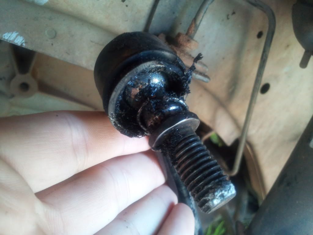

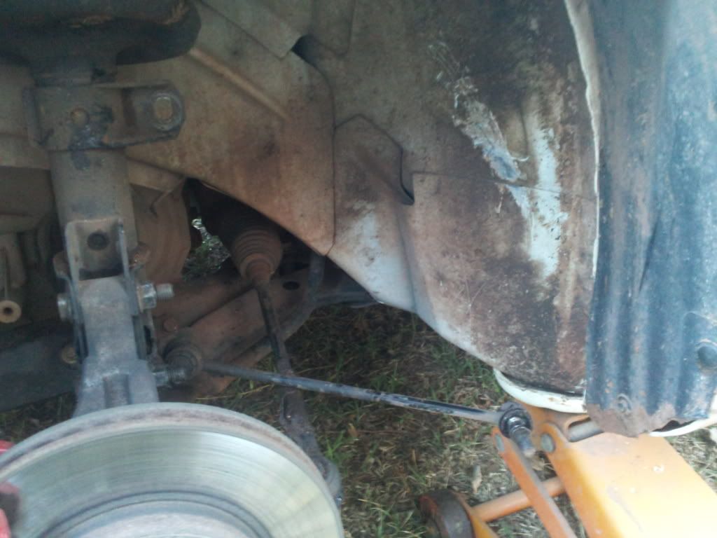

A couple of weeks ago I got my brakes changed and the mechanics told me I had a loose bolt but i didn't think anything of it (stupid mistake) So after work one day I was driving home and i heard horrible scraping and clunking noises so when I got home i found this. I know nothing at all about the suspension parts so if anyone could tell me what is broken I would appreciate. I need to get this fixed within the next day or two.
It is just laying to the side instead of what it should.

(Anti) sway bar link.

also known as endlink. or stabilizer link.doesnt look like it did any damage to the bracket on the strut. but id still look at it. and i would replace both sides if it were mine. they are pretty cheap.

endlink, easy fix but let me get this straight the mechanic told you, you had a bolt loose, did they offer or even tighten it back up? If not WTF, I would not go back to them.
