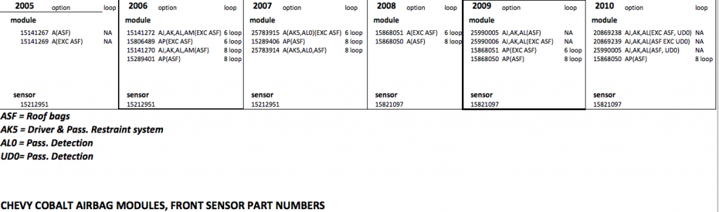

I see there are several modules between the 5 years of production. 05-06 share the same module but even within those 2 years, there is a different module for cars equipped with side curtain air bags (option ASF). The same is true for the 7-10's but none of the later years share a module between years (at least the non-ASF optioned vehicles do). There's also different modules for 6 loop or 8 loop, whatever that means. Hopefully the 07+ bag will work with my system.
I bought everything I need for the 4 spoke to 3 spoke swap minus the steering wheel airbag. None of it has arrived yet. I probably won't dig in for a while. I plan on working on the radio swap first anyways.
---------- Post added at 04:50 PM ---------- Previous post was at 04:06 PM ----------
Scratch that. None of the years interchange modules. Maybe a BCM thing? None of the years share those either.
---------- Post added at 04:58 PM ---------- Previous post was at 04:50 PM ----------
A little sheet I put together. The "Sensor" row towards the bottom is the sensor that's mounted in the engine bay.

I believe the 8 loop is for the sedan with side curtain airbags. There are 2 extra sensors one in each rear doors. Coupe doesn't need them for obvious reason and would only use 6
