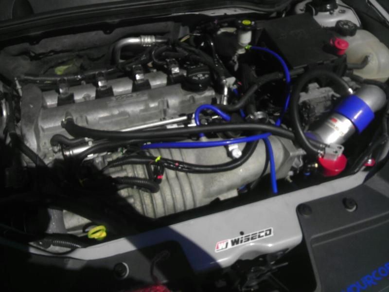

Engine bay now!
Engine as it sat supercharged

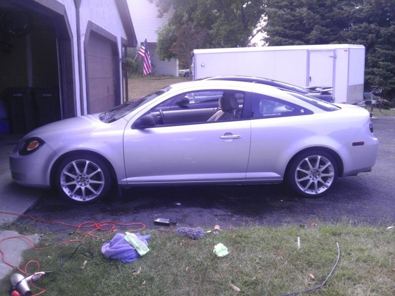

Took off the side molding

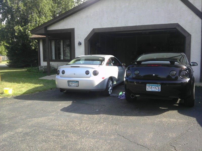

My buddy, Tom's balt and mine after we washed and waxed
