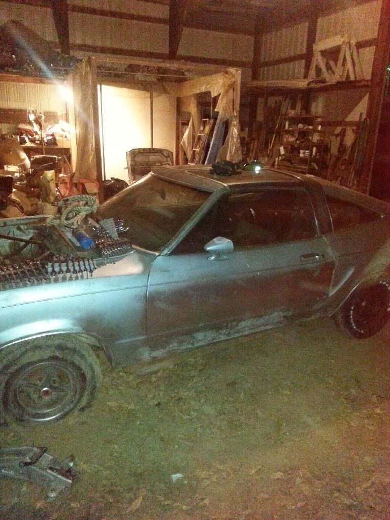

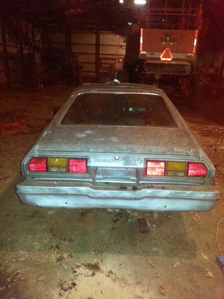

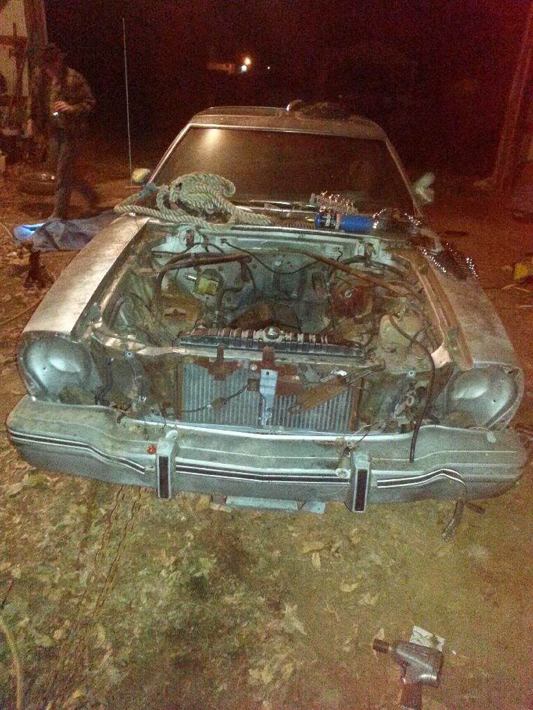

Me and my dad are starting an interesting project involving a cobalt and several other cars I am hoping the members here can help me with. It is a 1978 Ford Mustang II body and rear end that we are going to put a cobalt motor with the an AR5 transmission mated to it. My first question of many to come I am sure is how does the speedometer on the cobalt work?
Here are some pictures of the body as it sits.
