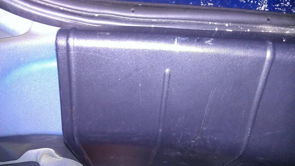

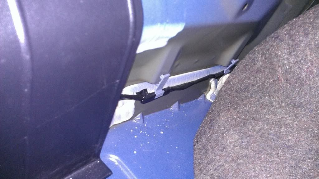

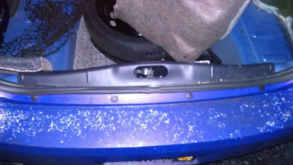

I keep blowing the PRK LAMP fuse. (I did see the vent off to the passenger side and don't think it's coming from that). When i have someone replace the fuse almost immediately i get a whiff of smoke coming from the vicinity of the edges of the plastic plate.
Here's some pics:
Me standing outside the car looking into trunk at the top of the plate.
From inside the trunk. No wires coming out passenger side.
Drivers side and a likely culprit. This wire bundle fits the bill but i can't get at where it's smoking with the plastic plate in the way.
I think the cluster fried at some wrapped point behind that plate. I just need a way to get that plate off and would prefer not breaking it in the process.

If you are talking about this black cover that surrounds the trunk latch it just pulls straight up and only held in place by four snaps to the compartment sheet metal. But there is nothing behind it.

You are correct Coby. That's what i wanted to know and that wire i thought likely only wrapped from the battery and was incidentally underneath the plastic. Back to square one.
After the dash lights go out there's a good 20-30 secs before i smell it in the cab. So i still think the wires causing me trouble are in the trunk. Any thoughts on that?

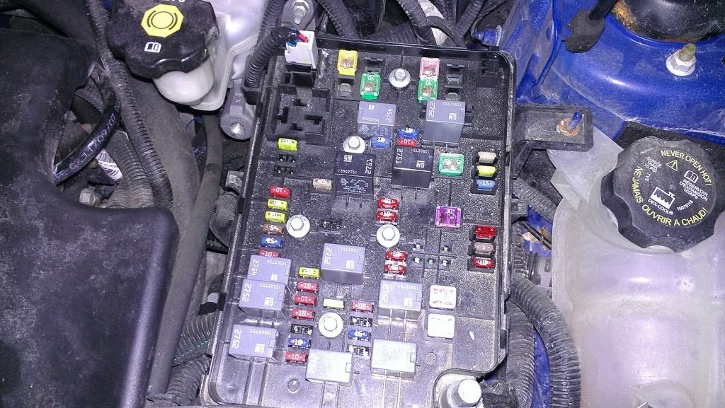

My fuses are all in the engine compartment. I have yet to locate a fuse bank in the cab. But the fuse that keeps burning out is the one marked PRK LAMP. When i replace it i have dash lights and running lights until the inevitable spark and smell of burning wire coming from the trunk. Is there another set of fuses? There's a hell of alot of fuses in the engine compartment. I question the need for more.
If you look at the left most mounting bolt (top to bottom it's in the middle) Then look to the immediate right you'll see where the 10 amp PRK LAMP would be if it didn't keep blowing.
I tried the 15 amp and got smoke :(

OK, we are on the same line path now. That fuse is suppose to be a 15amp at least that is what is in mine and that is what it says in the book. If you smell the smoke somewhere around that back plate it must be coming from the only thing that needs power in that area and that's the license plate lamp. Unfortunately the harness connector is behind the bumper cover. Have you tried removing the bulb to see? Did you check to see if all your bulbs were Okay?
And yes there is an other fuseblock inside the console accessible from passenger side.
Sometimes when bulbs burn they pull the 2 wires holding the filament inside the bulb together causing a short circuit. Make sure all your bulbs are good.
