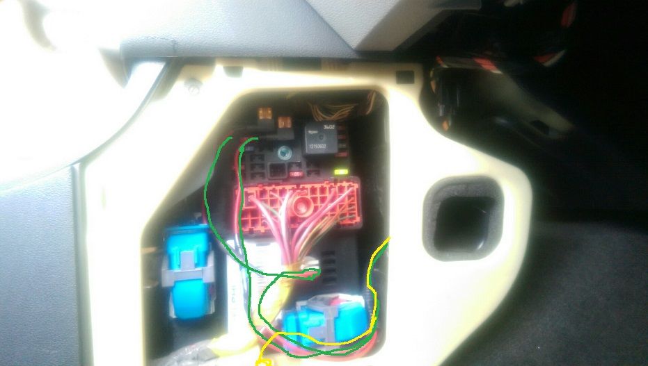

Here is the passenger side fuse panel. The positive wire off the power extension is in green, for visibility. The ground is in yellow and runs from the end of the power extension, through the wire loom, to where I grounded it. I have a picture of that below. For the end of that wire, I got an end that was a metal circle, crimped it on, and put the bolt through the center and tightened it back into the frame. (There are two power wires because I have another wire powering my gauges. You should only have one add-a-fuse wire)

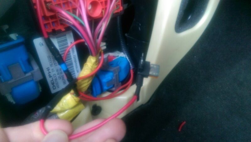

Here is the add-a-fuse pulled out. the original fuse goes in, as well as a new fuse rated for your application. The additional fuse should be of the same value or less as the fuse that you are tapping, not to exceed the rating of the add-a-fuse. To ease installation, I ran 18Gauge wire from the add-a-fuse to the other side of the car and attached it to the end of the power extension. That allowed me to run the wires without stretching them.

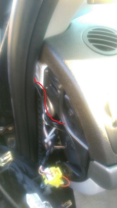

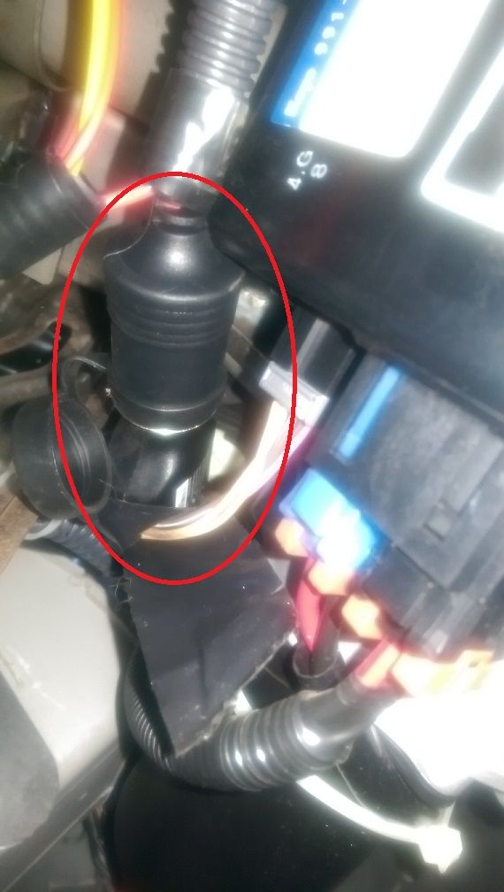

This is a shot on the drivers side looking under the dash. The power extension plugs directly into the car adapter for the GPS unit.
Run the gps wire up the drivers side of the dash to keep hidden.
Pull out enough so you can attach to the gps.

Don't put a fuse in the "Fuse tap" before you are all done, because you could put it upside down by accident. If you plug it in and your car cam already has power without the fuse it's upside down. Flip it and make sure carcam doesn't come on, then add the fuse. Max 2amp.
These 2 are tied together and are the positive side of the feed.
