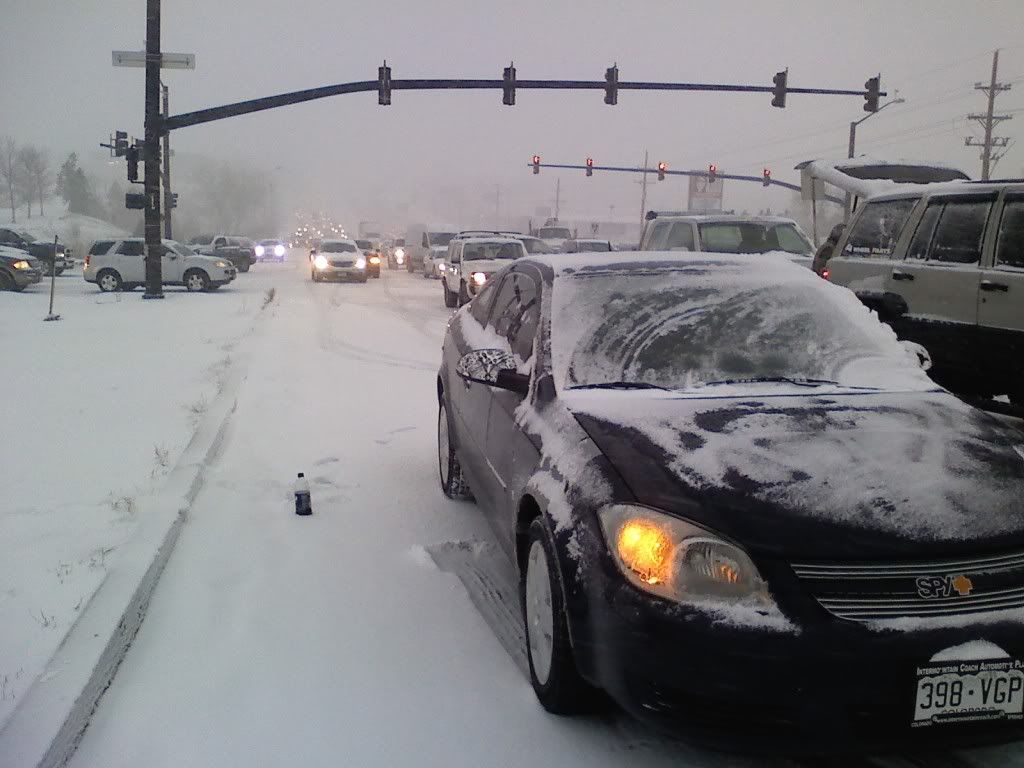

....when it comes to the snow...damn traction control made me bog down to a stop and got stuck here:
So pathetic! Luckily I obviously wasn't the only one stuck so my ego isn't as hurt. I have a service traction light on my dic and my abs light is on now :notrust:
That should not have acted like that,,, especially with the service lights on. Definite problem with that,, that caused your problem. See your dealer.

Haha alright here's the lowdown for ya'll:
Obviously this wasn't the storm of the century and was a relatively small accumilation (3-5") by Colorado standards. I got stuck here because some girl in front of me with a 2WD Ranger was doing the moonwalk with her rear tires, so naturally I had to stop. If not for that I would have had no trouble. Thus why it seems kind of pathetic to have gotten stuck where I did. The problem lies with trying to get moving again...let me attempt to break it down:
To the best of my knowledge I don't have a button to disable the traction control. I can tug the e-brake slightly, or put it in first, this cause's the DIC to display 'traction off' and the no traction symbol to illuminate. However, in first, when I rev above 4500rpm or so the ECU will cut power until about 1500rpm or until I regain traction (sometime's that's just off idle). I've always assumed this was a natural event and that my traction control wasn't truely 100% disabled even though the DIC stated so. Perhap's for warranty or safety reason's? Or do I have a trip to the dealer ahead of me?
With that said, this was the case when tried to get going again...nothing but bogging and no power being applied to the wheels, in any gear but especially in 'D'. This went on until finally my DIC read 'Service Traction' and my ABS light came on...I decided to ease up after that lol. Anyway I started her up today and no lights are on. I'm assuming I had too much snow on a sensor or it got too cold? Whatever can fix itself can break itself so i'm scheduling a diagnostic at the dealer here soon. Hopefuly this help's to answer everyone's question's lol.
