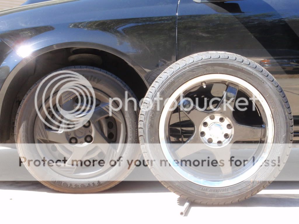

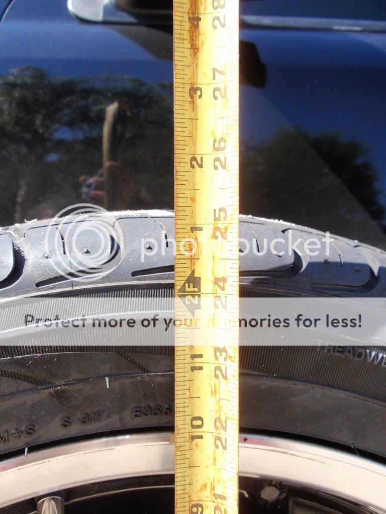

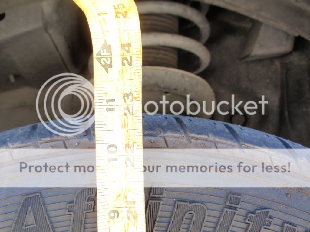

Alright, a few people have asked about my tire size and said that the Miata tire calculator is dead accurate... IT IS NOT, it is close, but it is not... I had to play around with the calculator to find out that the stock tires even brand new are only 185/55/15 not the 195/60/15 (this is because the miata tire calculator goes by quality tire specs instead of cheap GM 50 dollar stock tires. If you had a top end tire like Yokohama or Michelin then the tire size calculator would work correctly... Anyways, to get the numbers that match the measurements that I got just now, I had to input 185/55/15 which put me at 23" overall diameter, and the 235/45/17 is the same because my new tires are quality tires. This brings me to a speedo reading of 10.1% too slow where if I'm doing 60 I'm actually doing 66, and that is also a confirmed accurate reading according to my GPS.
Now that being said, if I do the math and my Average Tank Mileage is @ 350 around town I have to do this equation --> [(350x.101)+350]/12 = 32.28 MPG around town, as for the old way and what my DIC reads is 29.2... now for the Highway, I usually average 420 miles so [(420x.101)+420]/12 = 38.54 MPG, but my DIC always reads 35.1 MPG.
Now On To the Pics of the old stock tires (which my brother still has on his car, and has only 2300miles on them) to the spare rim and tire I have... Notice the Difference?
Oh, and these mileage numbers I get on average are always with a heavy foot. If I took it easy, I could get 32 city and 36 Highway on the DIC which translates to 35.23 City and 39.64 Highway. I'm sure that once I lower and get the Side Skirts I'll gain another MPG or so.

The lowering might help a little, but I do not think the side skirts will help without doing something to the front end to cut down on the air entering under the car.
You tires a lot bigger, and the math seems to make sense, but it still relies on the accuracy of the DIC. The only real way to get accurate numbers are to fill up the tank until the pump clicks off, run that tank, and fill up again at the exact same pump until it clicks off. You then take how many miles driven divided by the amount of fuel that you put in it the second time, and you have your mpg for that tank. Doing this 2 or 3 times will give you a solid number.
