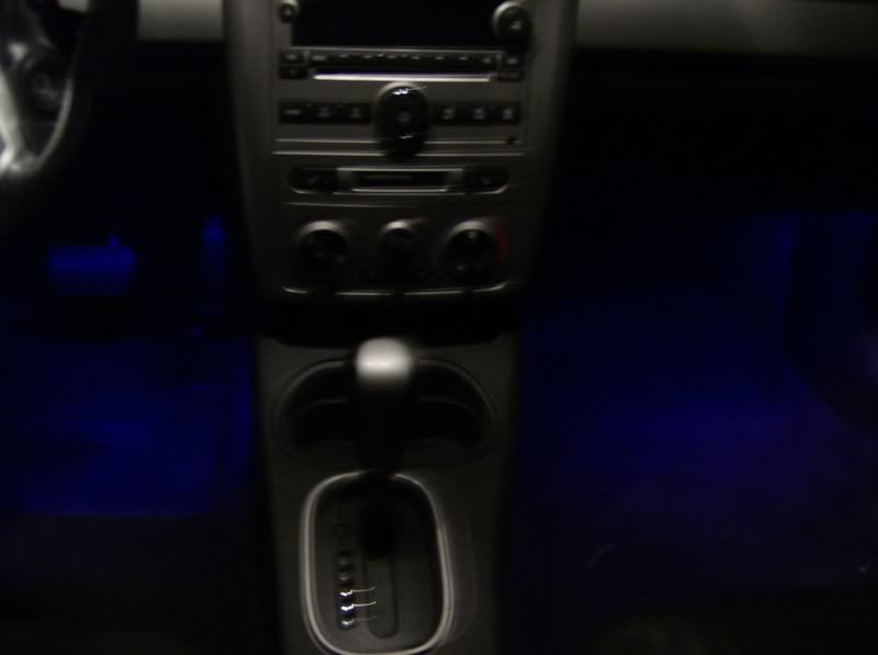

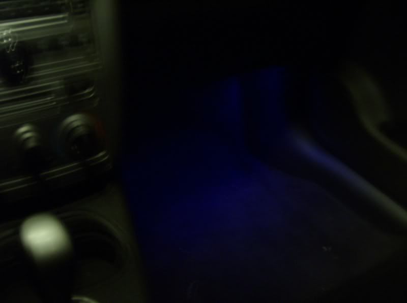

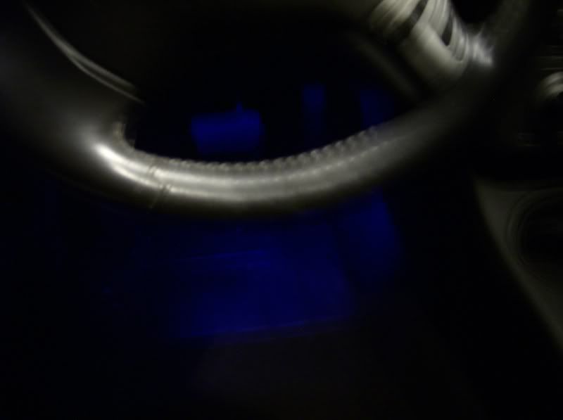

So i got my footwell LED's put in

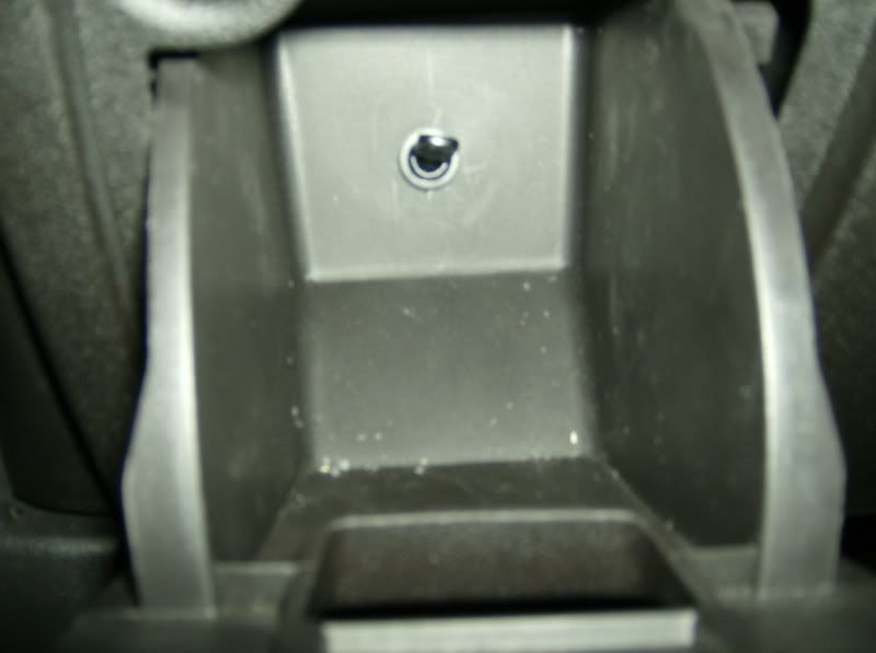

The pics are pretty low quality i know, but they look pretty good in person, and they only cost 9 bucks apiece. I hardwired it to the fusebox and wired a toggle inside the little cubby where the trunk release is.
Hurray for DIY Walmart mods lol.
