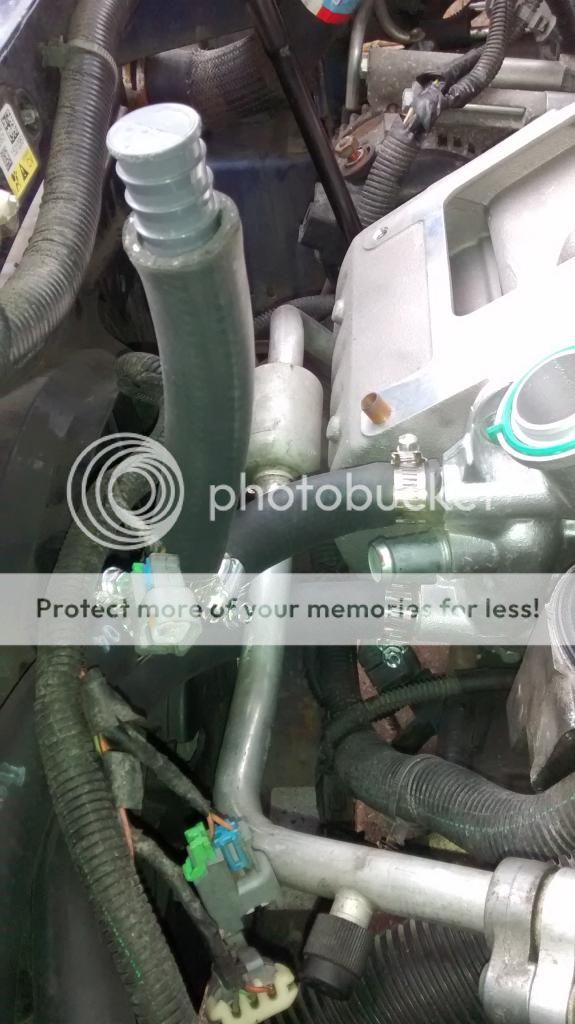

As most of you know, I've been in the middle of an SC install for two months now. I've got most of the hardware stuff done, but am hung up on a coolant line problem. Instructions don't line up with the pictures, hose measurements are all wrong and certain details are plain just not mentioned. I've got three inlets/outlets on the IM, yet only two are mentioned. Plus, it says to install a T junction 5" from the IM, but doesn't mention what that should connect too. I know I should be emailing ZZP about this problem, but maybe you guys could help. Here's a pic to help you visualize.
I've got the dual pass.

This one explains it the best, you don't have a surge tank though. Make sure the cores are in the right way for the dual pass.
