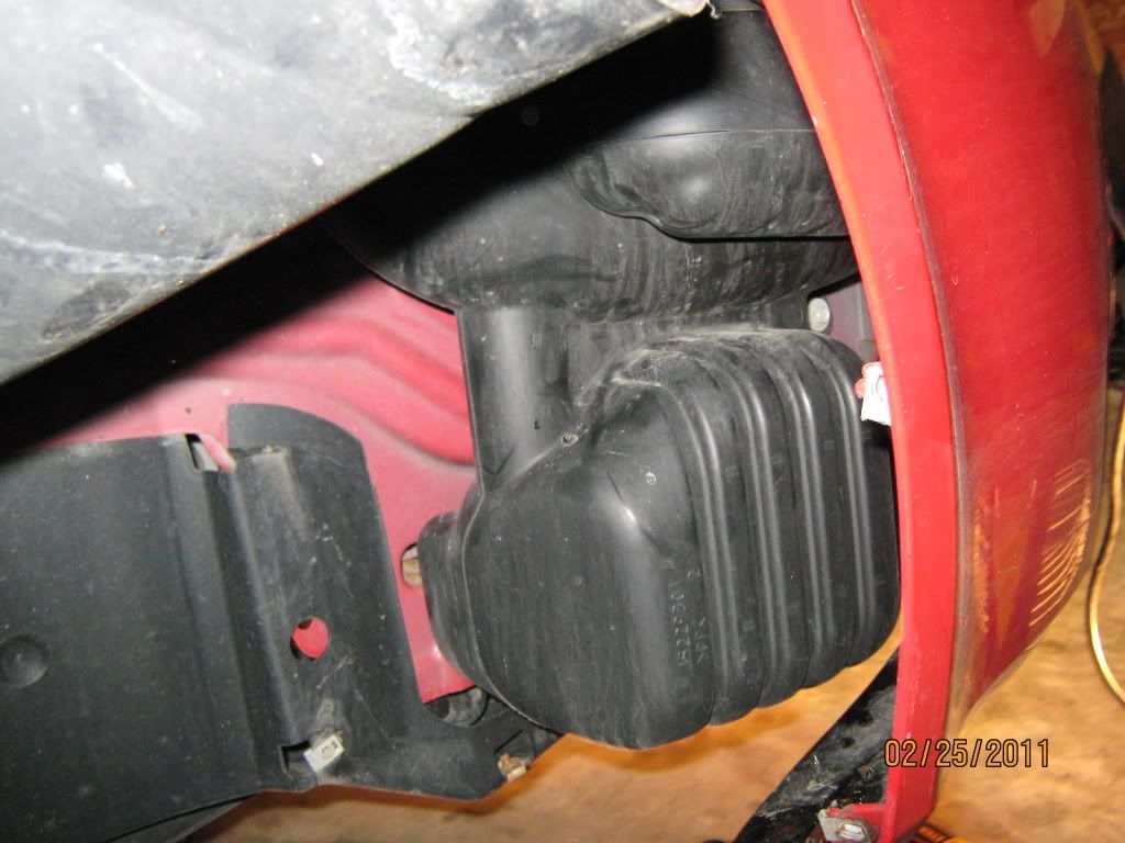

here is the bolt that is holding the silencer in to the right of the silencer bolted to the frame or part of it. there is one more plastic "bolt" in the back. easiest way to get to it is to the outside between the silencer and the "mud flap"
to get it out you will need to push in on the "mud flap" or whatever it is, dont push to hard or something might happen that you dont want... dont know what it is but i wouldnt try it. as you push it hold the end that was connedted to the airbox giving you enough room to get it out. there are three major "points" or "areas" to the silencer..

this is the last piece that is behind the silencer... hard to get to. i just pulled on it with my hands till i got it lose.

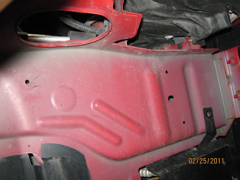

this is where it was.
this is the big empty void after it is taken out...

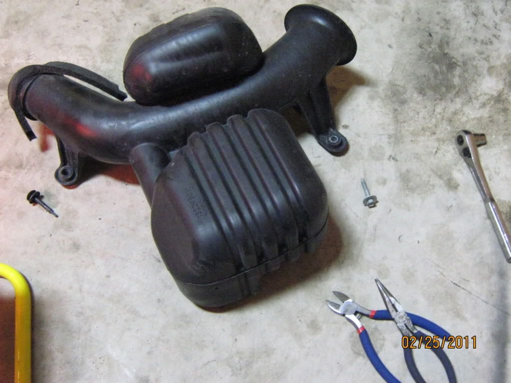

this is what the silencer looks like...

OK... at the risk of me being a little "slow" here. Your last picture of the silencer,, do you modify it in any way and re-install it or just leave it out and re-assemble the headlight ect.?
What was the difference you heard from stock?

i didnt mod the silencer and put it back in... at WOT you can hear a little bit of difference... sounds a little more throaty but not a whole lot. my wife didnt notice till i pointed it out to her. i could hear the diff right away. under normal driving i dont hear any diff, or notice any diff. i didnt do it for performance relaly wanted to see if there is better gas mileage to be had. i am on my way to work now and should know by the time i get back if it gives better mileage or not.
