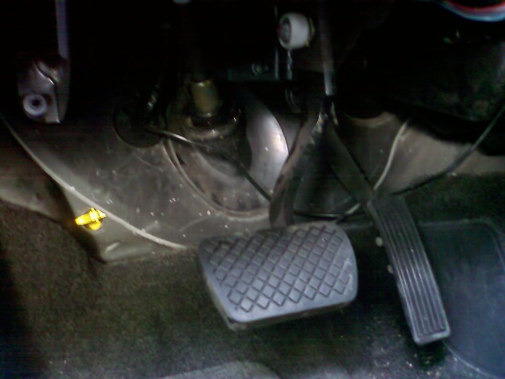

Put the wire threw the fire wall(you will have to remove a cover to get it threw)
Your going to have to find the harness for the transmission and look for a light blue wire with a White stripe and orange with a black stripe NOT THE ONES TWISTED TOGETHER!!!Connecting to any other wire it will NOT work
Tape Red wire of shift plus with orange
Tape the black of the shift plus with the Blue
And tada your good to go
