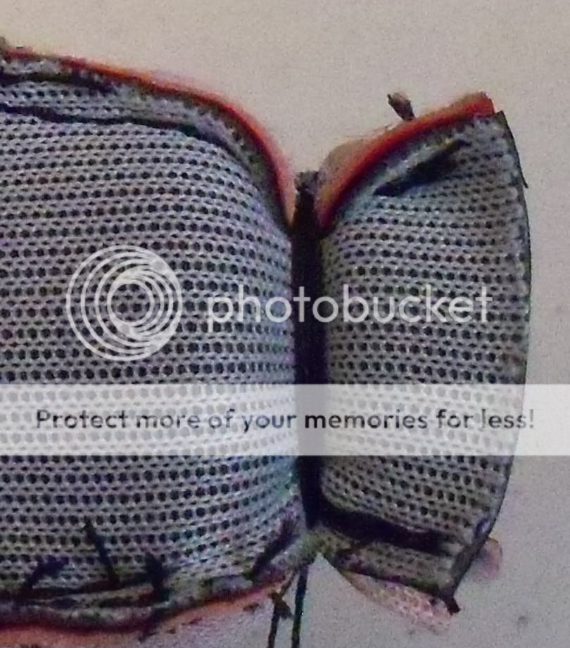

4. Turn your boot right side out. It should look something like this. At this point you can do a test fit over your retainer ring to check it's right.

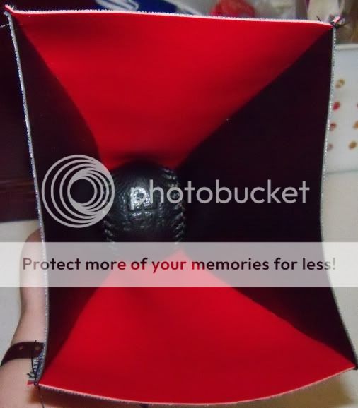

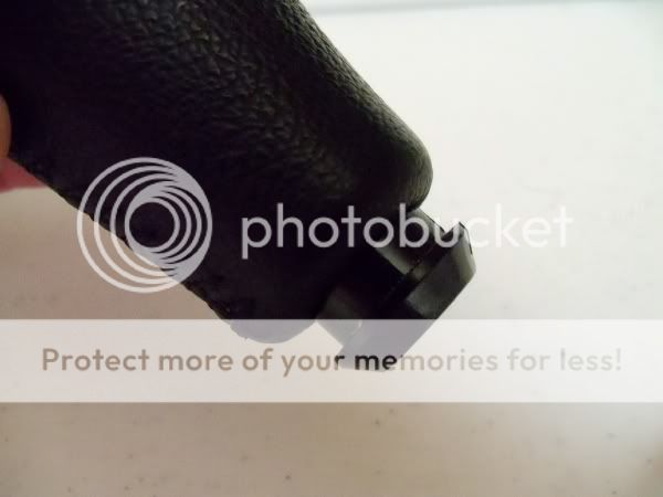

5. In my case, it's easier to attach the boot to the knob before attaching it to the retainer ring. My shift knob looks like this.
6. Turn the shift boot inside out, and place the knob inside the boot, pushing it as far in as you can. Line up front/back of the knob with front/back of the boot. If narrow end of the boot doesn't fit tightly, you'll need to re-sew the seams at the narrow end so it does (don't need to remove old seam). Trim to 1/8" of your new seam.

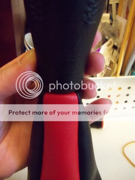

7. Use a zip tie or the strong thread wrapped around the retainer ring of the shift knob. The zip tie isn't my first choice, it leaves a bulge that you can see, but it does work.
8. Turn the boot right side out again. The knob is now attached to the boot.

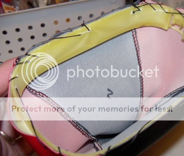

9. Attach the boot to the boot retainer ring by using the holes left from the staples to thread the boot onto the plastic boot retainer. Wear vinyl gloves (like medical/latex gloves) and use a small needle, and it will be easier to pull the needle through the small holes. You could add glue if you don't feel this is enough. This has always been enough for me.

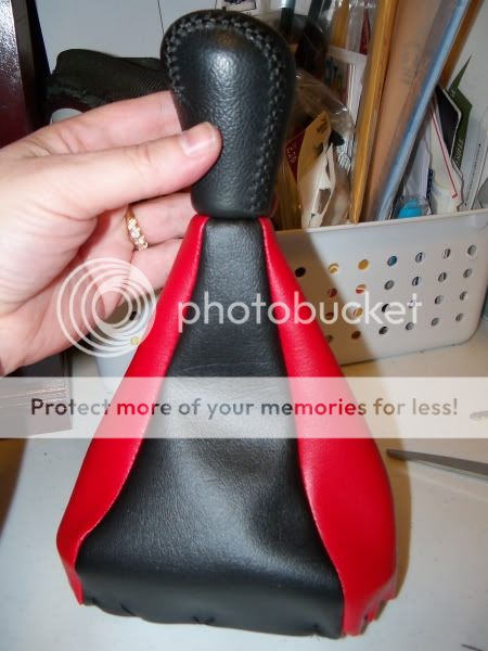

Here's the final product before installing it into your car.

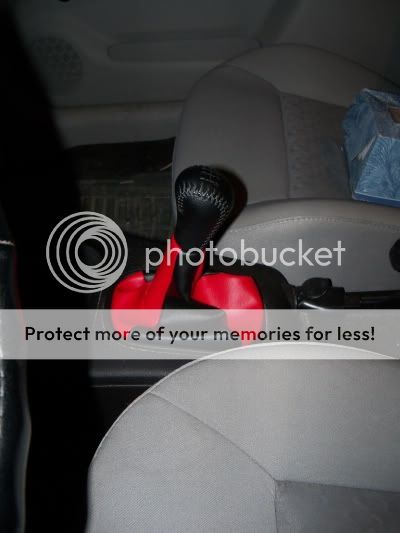

10. Reinstall into the car.
