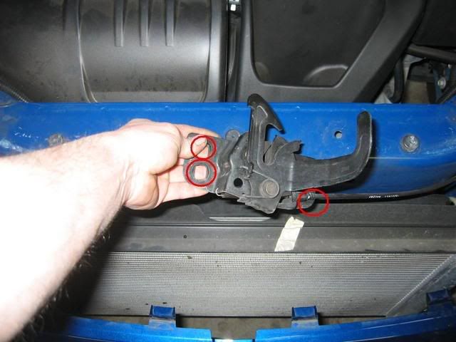

Next you want to pull off the hood latch mechanism. it will get in your way the whole time if you don't. There are 3 bolts that hold it in. The bolts are 12 mm and are circled in the pic. When you get it off just put in in the engine bay to get it out of the way.

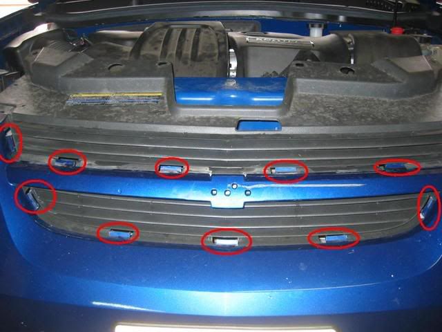

Now comes the interesting part. There are tabs that have to be unclipped to get the grill out. In the following pic I have the grill unhooked but still in there so you can see where they are. To get them out, I folded small pieces of cardboard and stuffed the cardboard in the front of the grill where the tabs are to keep them from reattaching.
When you get the tabs unhooked then pull the grill out, it will take some wiggling to get it out. A good piece of advise is to practice getting it back in to prevent damage to the paint when you re-install it. Now you have a big open space in the bumper...I circled on this also where the tabs are.

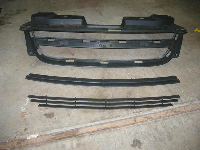

I used a small saw to remove the slats up to 1/2 inch from the side and then a Dremel with grinding wheel to get the rest off. You are going to scratch and possibly gouge the side of the grill while doing this, it is to be expected. After you get the pieces out then you are left with this.
