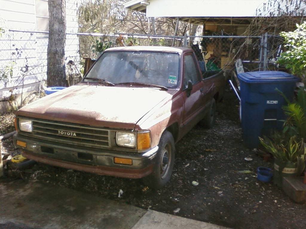

to my understanding, its a 1988 toyota whatever idk pickup:huh:
It used to belong to my aunt, and since maybe 2000 its been sittin in the back of my driveway, never really bothered me, or my parents about it bein there, i finally asked about what they planned on doin with it. turns out its going to be mine now, i knew it was a longshot but i went out got in, tryed to start it.....nothing, i just went back inside after that, ill post up an update to see whats not happening under the hood, hopefully i can get some help from you guys

I'd just sell it, unless you really want to tear into it.. If your just now trying to start it, I'm guessing you have little to no interest in it.

that is why I said get it running decent or whatever and get something for it. I woulda junked my cavalier had I known how much it would of cost to rebuild it and get it drivable. I could paid off 3000 off my cobalt loan or used that to buy another used car lol. But I am sure his engine is not blown on it. Probably needs fresh gas, an oil change, maybe seafoam(after it can fire repeatedly), new plugs, battery. Once its running you well either want to replace brake rotors/drums, new pads, few other misc. things, definitely tires if its been sitting. Even if they look good you still could and probably have dry rot in them and that would suck driving and having one blow on you.

True and with a toyota cleaning rust is a good idea as(I am not sure on the years) the trucks frame have been known to rust and fail, causing some serious injuries or death of the occupants. BUT, you can clean the rust off better if its RAISED, hahaha.
