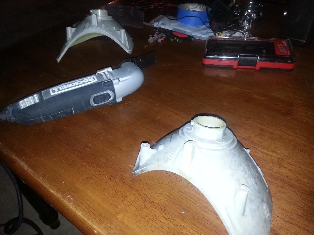

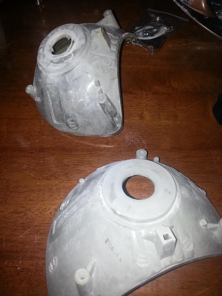

Used a multi tool to cut the rear rings behind the bowl for the projector to fit snug
Used the sander on the multi tool to get a good smooth back after cutting the ring off
Dremel the 3 points in the bowl ring to get a smooth ring

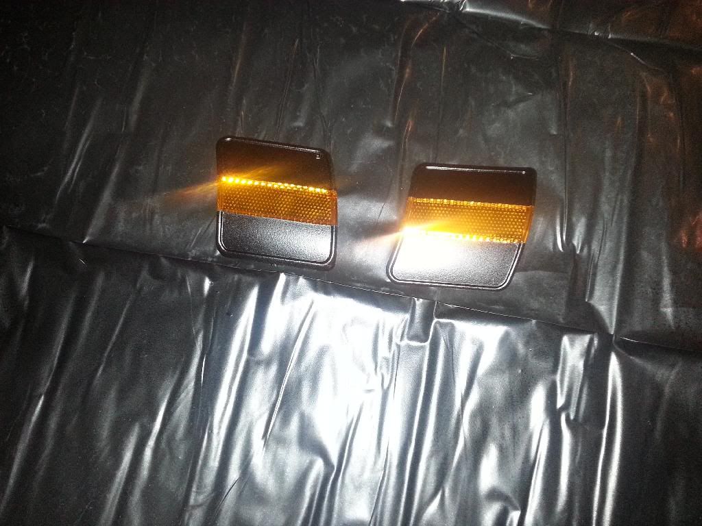

Taped off the middle part of the side reflectors
Primed the side reflectors
Painted side reflectors Satin Black
Side reflectors finished

Drilled holes in the back of the headlight plastic for the Ccfl connectors to go through
Drilled holes for the solonoid wires to go thought
