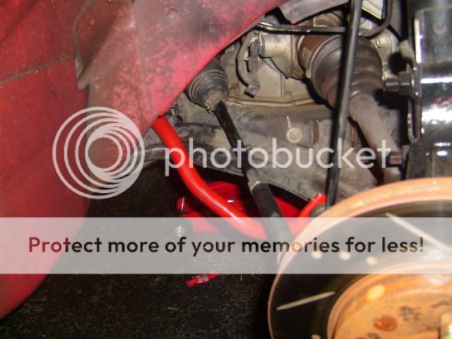

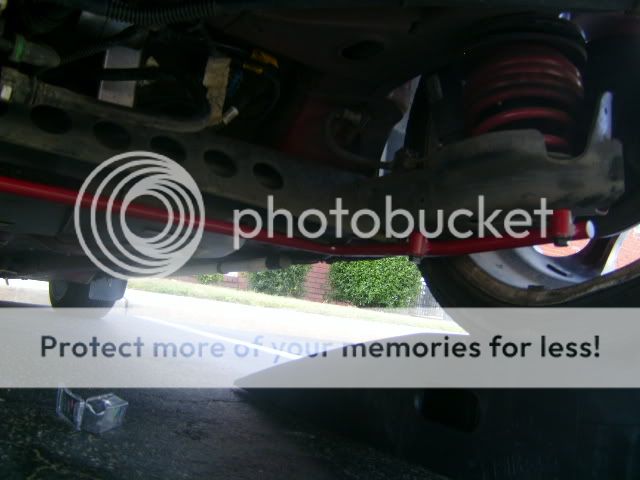

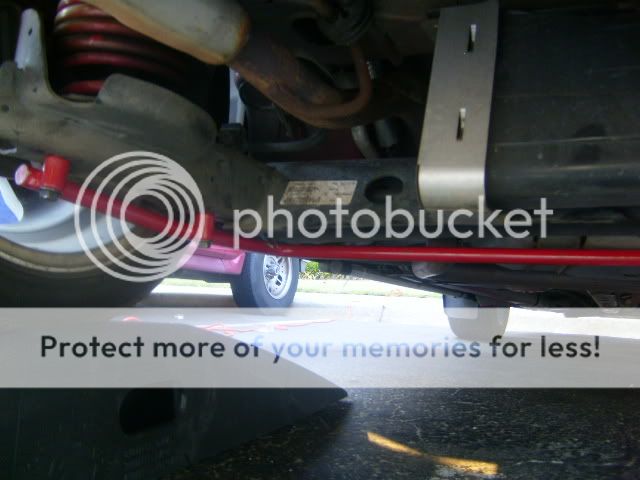

sway bars are from Kuruma Motoring and rear took about 20 mins the front is a pain in the ass cuz you have to take both wheels off and remove the rear trans mount, took just about 4 hrs to figure out.
So you didnt have to drop the sub-frame? I have heard of people doing it this way. but they had to remove the downpipe also.

well it says it on the parts that was the name and when i looked on ebay thats the same ones i seen in green. i tell you its worth it, ive never felt like i griped the road so well only thing is the stabilizer bar is alot bigger and because of that youll hear it scratch the frame a little but no damage done or hurt.
