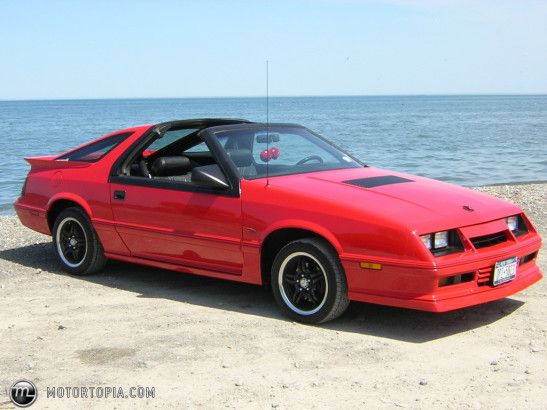

I had a Daytona back in the day when I was in my mid 20's was such a fun car but was the older much slower one "86 CS Turbo with T-Tops" cracks me up now that it had like 140hp but was still a fun car to drive and the design and inside was so cool had the pump seats in it and rear sun visors
My Daytona looked like this one but with the Swiss cheese styled rims and rear louvers and tinted windows was such a sharp look car!
