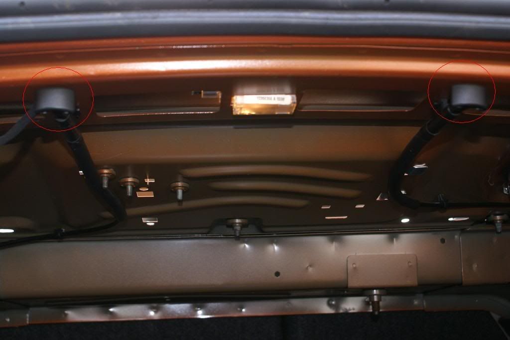

9. Go in to the trunk and using the needlenose pliers pinch the tab and push up. The tabs are located above the rear seat releases (there kind of hidden). there's two of them. They can be tricky to get out of there.
Heres a pic of the tabs
10. pull the whole thing out.
