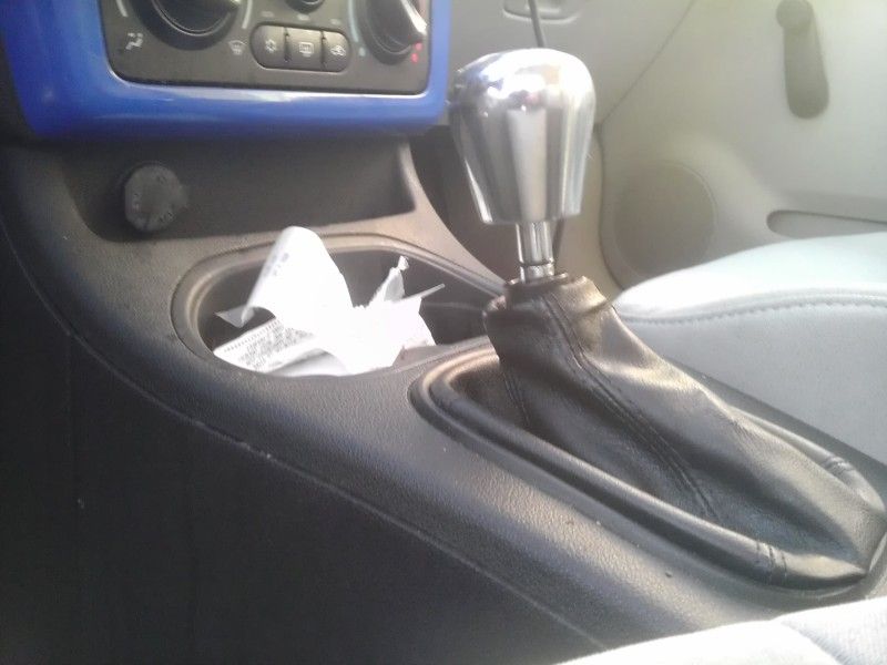

I mean if I can cut mine and get virtually the same shorter throw then I will just do that, but if not ill just get the Cosmo and cut it to be the same height as the one in the pic. I like the stance haha

Oh okay. Well I'm definitely going with Cosmo for STS but I just kinda want the stance in the photo from the site.. If its not possible or practical then I won't do it at all ill just keep whatever height the shifter gives me, but I want to have that shorty stance nam sayin' lol

Well, we can confirm with Banker but I'm pretty sure they all look like that. You use your stock boot.
4,647 Posts
That's how short it is. It's in first. I have a video somewhere on YouTube that shows how short the throws are. I'll find that too

To shorten the throws, you need to add to the bottom of the shifter rod under the pivot point. To shorten the shifter, just cut and tap the top. To shorten both, take off from the top and what you take off, add to the bottom and adjust from there. It is a pain to do the cutting and welding if you don't know what you're doing or if you don't have access to a welder, but STS's are the same thing as the stocks except with a longer bottom half. That's all. :)

How many times do I have to tell you that it IS the damn Cosmo shifter
