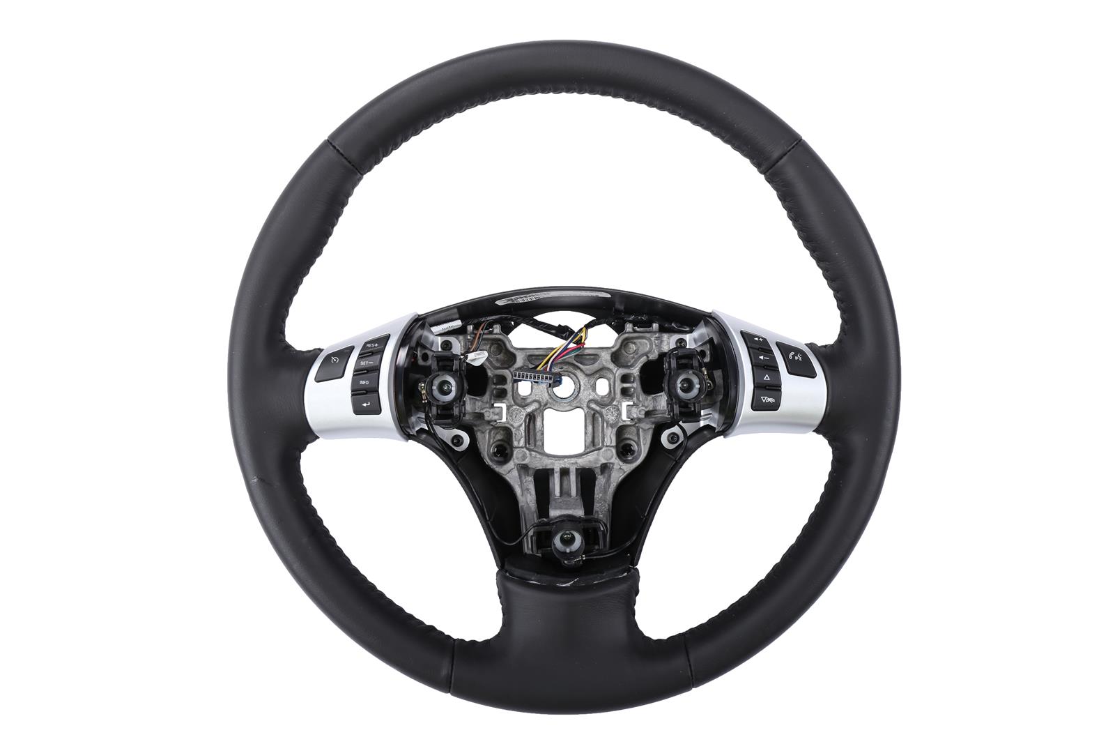

Hey Ya'll, I've been trying to find a steering wheel with both radio and curse on it for my 2010 Chevy cobalt but the only thing I can find is 2 junk yard wheels that may or may not have the switches and this wheel from summit that goes on a 2010 Malibu.
ACDelco Steering Wheels 20814867
So my question is will this wheel fit in my car? Its a ACDelco Steering Wheels 20814867

I’m running a Malibu steering wheel in my 08 LS. Bolts right up.
You will need to change the wire order to match the order in your cobalts clock spring and
You will need to be a bit creative in installing a Malibu’ airbag into the cobalts wiring. The connectors were a bit different but one can make the work.
