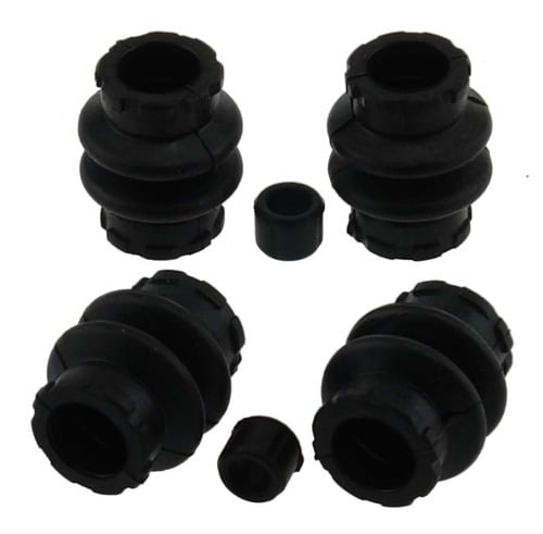

The two little rubber bushings in the pic below are the ones that seems to have swollen and caused the pin to be hard to move. I replaced them. Nobody seemed to know exactly what they do. But I believe they may help the caliper push back to keep the pads from dragging. Any time I install them they seem to push the pin back out. So I suppose that’s what they do. Either that or are some kind of vibration damper. In any event they are needed. They fit on the slot at the end of the top caliper pin.

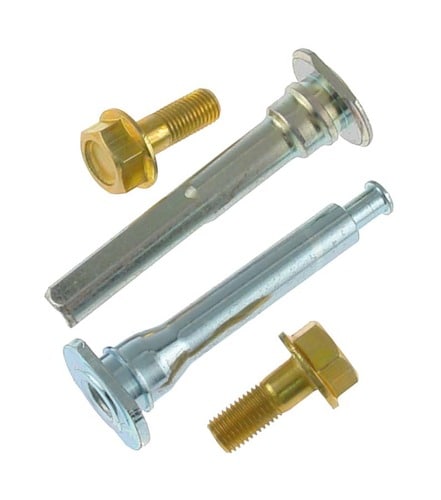

The problem with the brakes cause my fuel mileage to drop dramatically. It would only manage to get 18-20 mpg. On my drive I took after the new hoses, it averaged 30.5 mpg. Mainly driving 65-70 mph with several stops and a portion was 35-45 mph just driving around town. I didn’t end up using the new caliper pins so I’ll return those and probably get the control arm bushing and transmission seals. Later on I’m going to replace the control arms with the aluminum ones. The bushings were only $10 each so I figured why not just pop those in for now.
