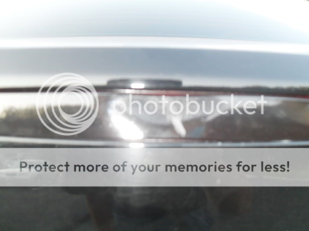

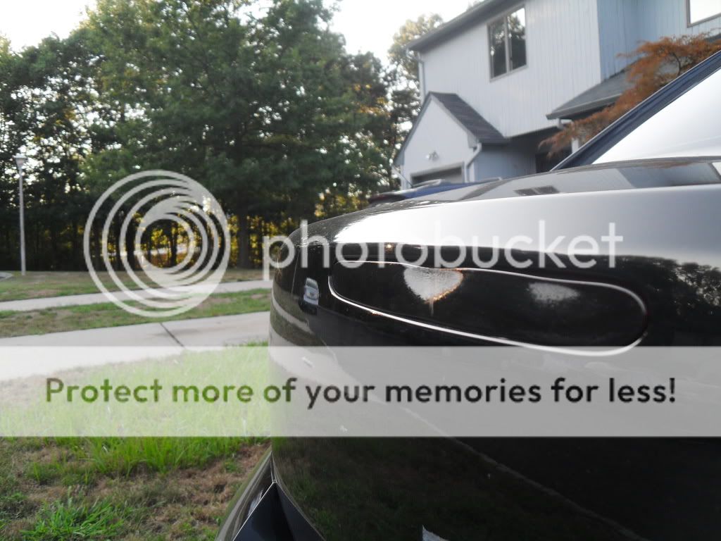

lol the third brake light is melting...??
i have NOT moddified the bulbs at all... im thinking its a combo of extream sunlight and too much nightshade??... idk
happen to neone else
thanks guys

Wow, that's pretty ****ed up - I wouldn't say Niteshade caused that though...

Your housing is getting to hot, I have seen this when guys use way to much VHT, the heat from the bulbs have no where to dissapate to. Just saw it the other week on an orange Grand Prix.
was my better guess... im not kicking myself for it or nething hell its only a third brakelight... i guess thats what i get for going so dark...

I actually have a really small spot on mine like this but its barely noticeable unless you look really close at an angle...

I agree that the nightshade is causing it. The black absorbs more heat and regular bulbs get hot. LED's would solve your problem I bet.

ill agree with everyone... im sure its a combo of the nightshade trapping to heat.. the hot summer sun and the extended amount of brake light ussage from jersey shore traffic (lmao)
thanks everyone for the help...
ive unpluged it for now.. to provent a huge hole in my trunk... ill order a new one next paycheck..

I was going to say there is no way it is sunlight/exterior heat. It has been 105+ for a month here and mine has not done this.
