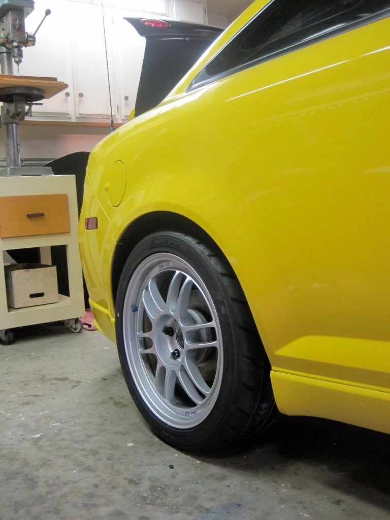

what'd you need for the 114.3 swap? I want RPF1s or TE37s lol

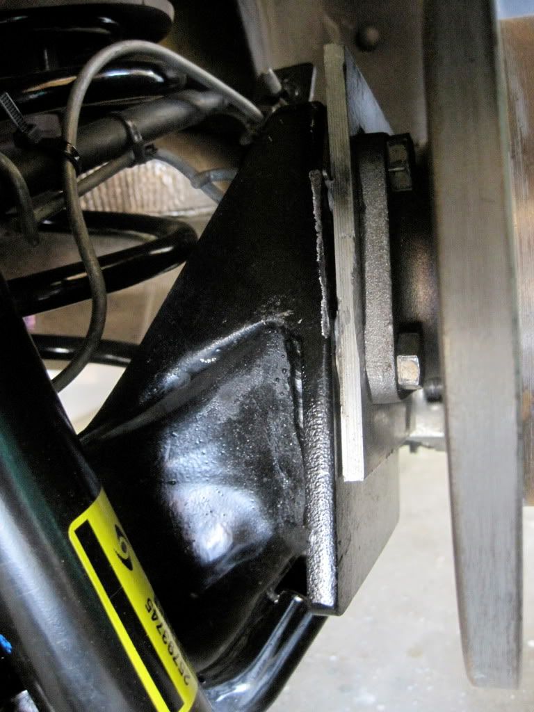

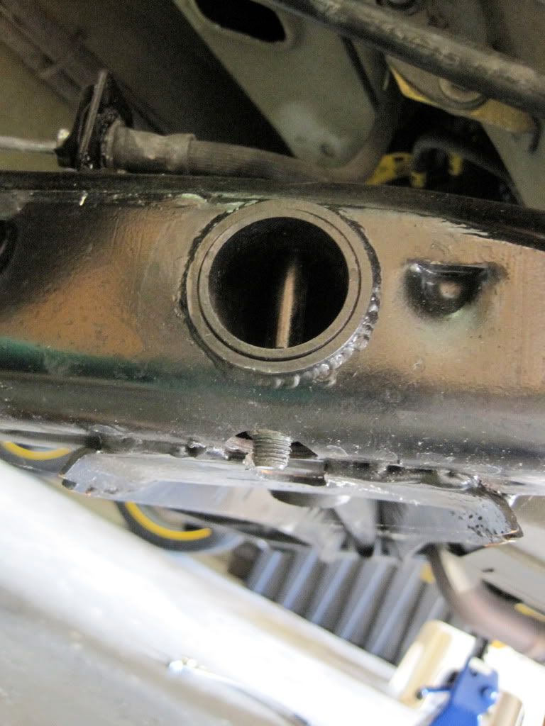

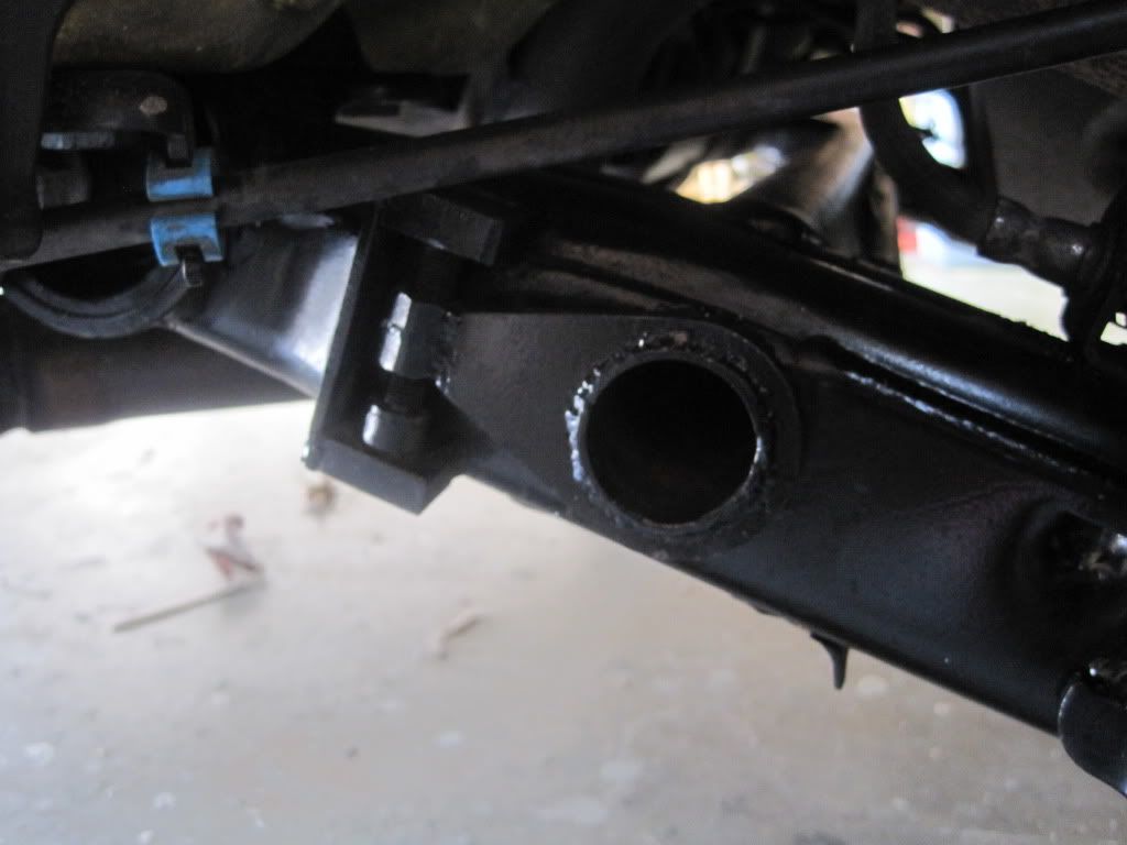

oh, well that stinks. the 5x114.3 swap was retarded expe3nsive because there are no aftermarket hubs that bolt on and match the abs tooth count. The rear beam was going to have to be custom, so Powell just used the jigs etc. that were available and built be a Time Attack beam. Complete with spherical bushings, integrated/adjustable sway bar, revised shock mounts etc. $$$
The front is just a simple swap.
